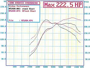

Same car, same day, same 91 octane. Before and after flash.

Why do you lose torque on the low end? I know... I know... you can't have it all... right? Just curious about the reason.

As mentioned in the other thread, the stock car would knock at 4000rpm, inducing knock sensor activity, making power from 4000-5000rpm very inconsistent and lumpy between runs. I had to adjust timing and fuel curves accordingly to fix this. Cost a bit of torque in that narrow region but I couldn't really help that. This will not be an issue with the 93-94 octane maps which are actually more (not less) aggressive than stock in that region.
