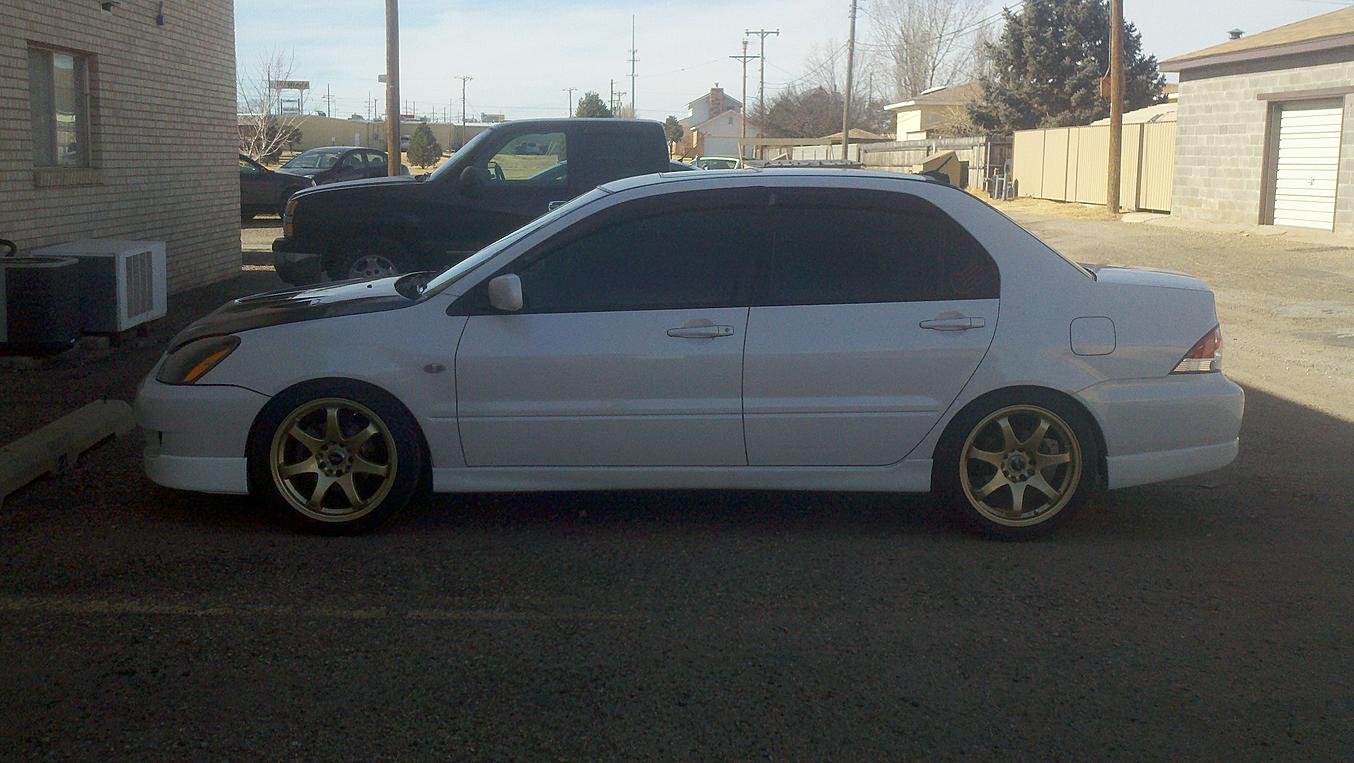

OOOKAAAAY!!! the people have spoken!!! here is your side pic. enjoi
i just got done pulling the fenders just a tiny bit, and re-rolled the fenders, now the only rub i have is in the front front the plastic inner liner. i should have went with 215/40's instead of 215/45's oh well, ill figure something out to have it not rub so bad, maybe sand it down? well see....
-Flip

****.... It looks good to me bro better than I thought from the first few pics.

Ok the side pic says it all, it really does look great.
So who did you get to pull and roll your fenders?

for rolling i used a heat gun and a rubber mallet, took my time and carefully watched my work as it was being done.
for the pulling, i only had to bring it out just a tiny bit, not like K3lv's monster +20 17x9's lol. so i just did the phone book method first, but just ended up using a wedge (more like a rubber lever in a way) to apply under the fender lip where i needed it, jacked up one wheel at a time, stuck it under the fender,lowered the jack a little, used a heat gun and just pushed down. the oval end of the tool pushes the fender out as i applied pressure to it downwards, giving me just the clearance i needed. now to just figure out if i can somehow grind down the plastic where the tire rubs on in the front. ill think of something.
