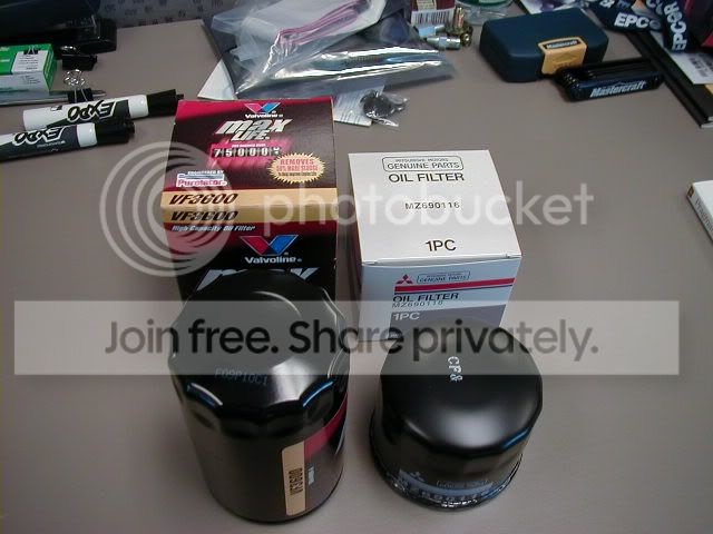

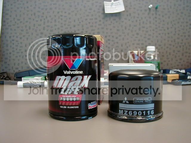

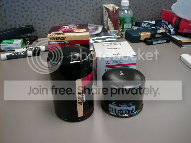

Old Apr 1, 2005 | 08:00 AM
  #39
sillypuddy's Avatar
Posts: 1,241
From: Toronto, Ontario, Canada
my new oil filter compare to the stock one
-joe
-joe
I feel it wuld be a bad idea to use that long of an oil filter, unless you have relocated the filter placement that will be below the control arm and it would be an object that could be hit if something were to be on the road. Am I missing something.
The oil cooler is a great idea, and for MOST of us I doubt it is neccesary. The MIVEC is not what is causing the heat, it is the high RPM's on the highway. An oil cooler will add capacity and shoudl come with instructions as to how much extra oil to add. Have you installed it yet? After having the front bumper cover off you should have room to put it on either side behind the foglights, Of course you will need a custom bracket but I am sure you already knew that.
