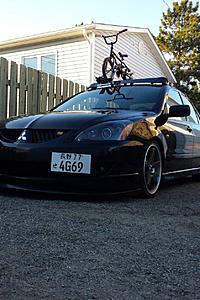

Scaping on paved road.. So now i really have to look for every bump, it's not my front bumper who scrap anymore its the exhaust but im lowered quite a lot

Yeah that would make a little bit more sense. The flange on the DP is at a weird rotation, might have to do some custom piping to get it back in its groove. Or cut and turn it might help you out. Does yours smack your trunk area? Right where the spare is?
