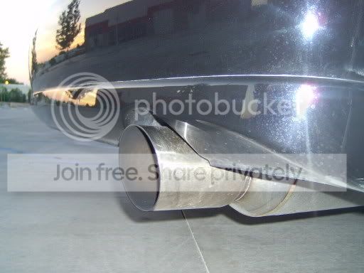

Old Jun 27, 2006 | 05:46 PM
JPerezz21's Avatar
Posts: 56
From: Tampa, FL
Old Jun 27, 2006 | 06:17 PM
Arithmetic's Avatar
Posts: 3,856
From: So Cal
Exclamation
Originally Posted by JPerezz21
Whoa dude, it is waaaay to close to the cutout. I just measure mine, it is only 1.5inches from the cutout tip. Still angle and tuck in nicely. Here is mine:
