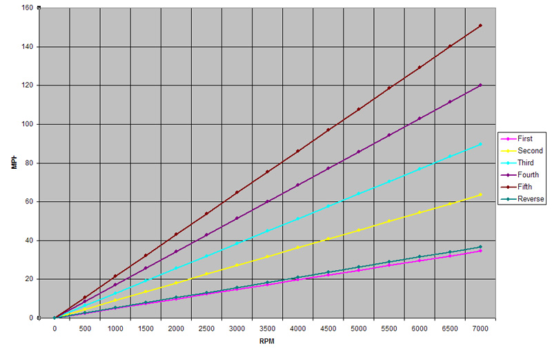

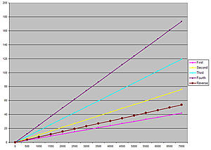

Originally Posted by bruce988jl
Now if only myz saved us some time... ahem graph ahem.. haha

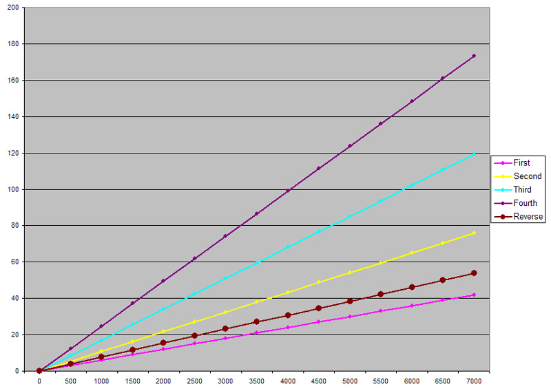

Based on a theoretical 7000rpm rev limiter. Yes, you can go faster in reverse than you can in 1st gear.

Myz, do you have one of those for autos too? lol it seems like you're the person to see about this kinda thing.

Sure. Here you go. This one is based on a theoretical 7000 rpm rev limiter *AND* a locked torque converter. Actual speed vs rpm would look like curves instead of straight lines, and will be a little lower.

wait, so we can max out @ 150? and autos can max out @ 170? what am i missing here
Old Apr 10, 2007 | 02:40 AM
stEVOx's Avatar
Posts: 1,191
From: Australia
^just theoretical, dont think exact, but if it is true, maybe coz its only 4 gears, the 4th is really long ?
