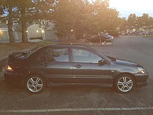

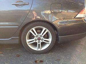

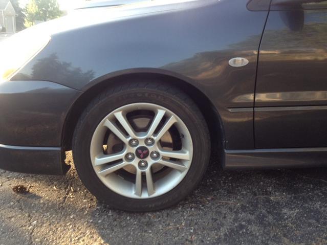

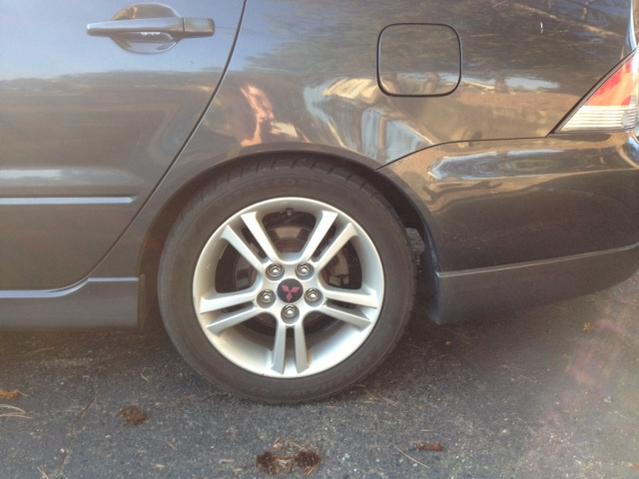

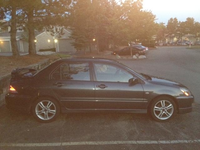

ps heres the pics..
honestly the pictures make it looks like its still lifted on the front but if u see the car in person it looks almost even..like i said before it looks ~1/2 inch different..

myself i had major rear sag, and that doesn't look bad at all, nice job...
