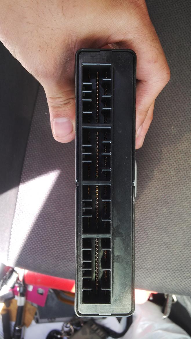

UPDATE: I noticed the acceleration harness was quite loose so I tightened it up a bit and took it for a spin. This time I noticed that my car actually doesn't shut off, the car just looses power after a strong throttle, rpm drops to 500 when idle, shakes like it's about to die and revs feel heavy, and car had to be shut off and turned on to cure it.
I unplugged the ecu not sure if it is the ecu but it's sitting in my room once.the sum is down I'll plug it back and see what happens. I couldn't check on the maf yet I'm still waiting for another pair of hands.

Ok so far I've plugged back the ecu and no difference car still shuts off after a strong throttle. Checked the powers of the wire to the maf and to me they seem like there getting it. My only option that I can think of at the moment is to try and find someone who has that sane maf and in working order and try it out. If I'm getting the same thing then I know for sure it's something else or the plug itself. I can't think of any other reason this would happen. Today I tried throttle it and after it shut down I got all 3 codes for the maf which hadn't come on for the past few days when it actually shut off and I got the code 44 ign. Sgnl 1. Now I'm not even sure if the code 44 is even related to ignition coils.... im just lost
