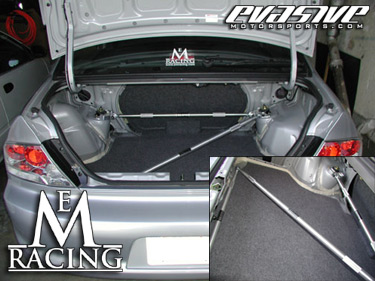

Here is a good picture that will expain the BIG difference between the Evo Rear strut mounts and ours. Pay attention to where the struts mount.
EVO
RALLIART
Just wanted to give a visual on the differences.
OP your probably better off looking for Tein Basics or the Megans like Smike mentioned. Or there is always the KYB GR-2s and Tein S.Techs.
EVO
RALLIART
