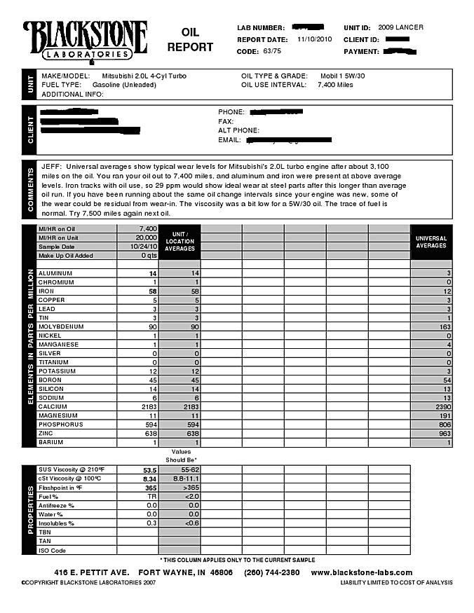

I just got my oil analysis back from Blackstone Labs. I have to say I am really impressed with the way Mobil-1 has held up.
I don't track the car, and my daily commute is pretty relaxed, but there is some stop and go traffic. My only mods are the GST 93 tune and pill, and an evo X bov.

Very interesting information about Mobil 1.
