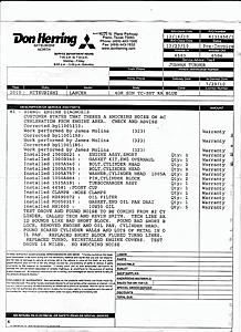

here is the paper work i got from the dealer
