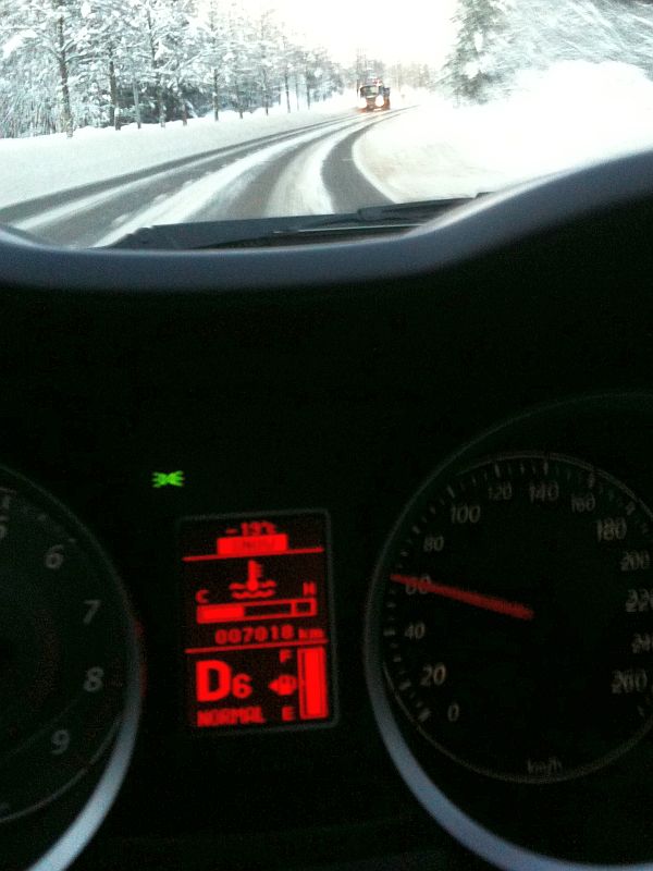

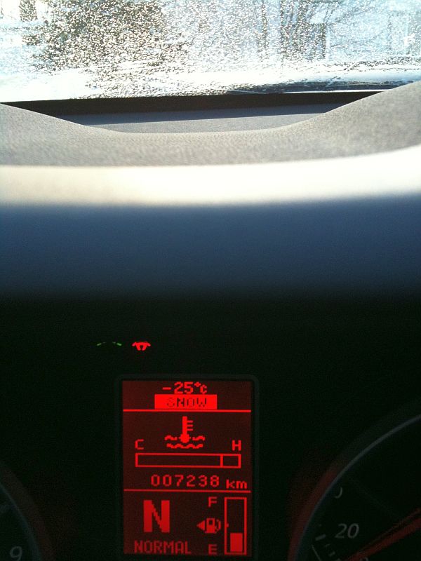

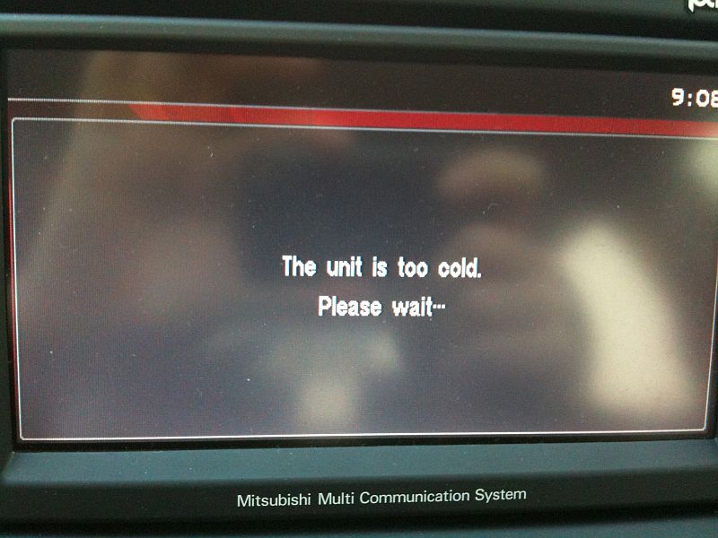

Well, my Mitsu got a good cold weather test this morning. In the night it was around -30'C, and in the morning still -25'C (around -13'F)....
MMCS wouldn't start (1st pic) before it heated up the HDD for a few minutes :P
Car started fine (I had the block heater on for 2 hours first of course), there was a squealing sound at first (fan belt?) but then everything was fine. A few more degrees less and diesel car drivers will have frozen fuel...
