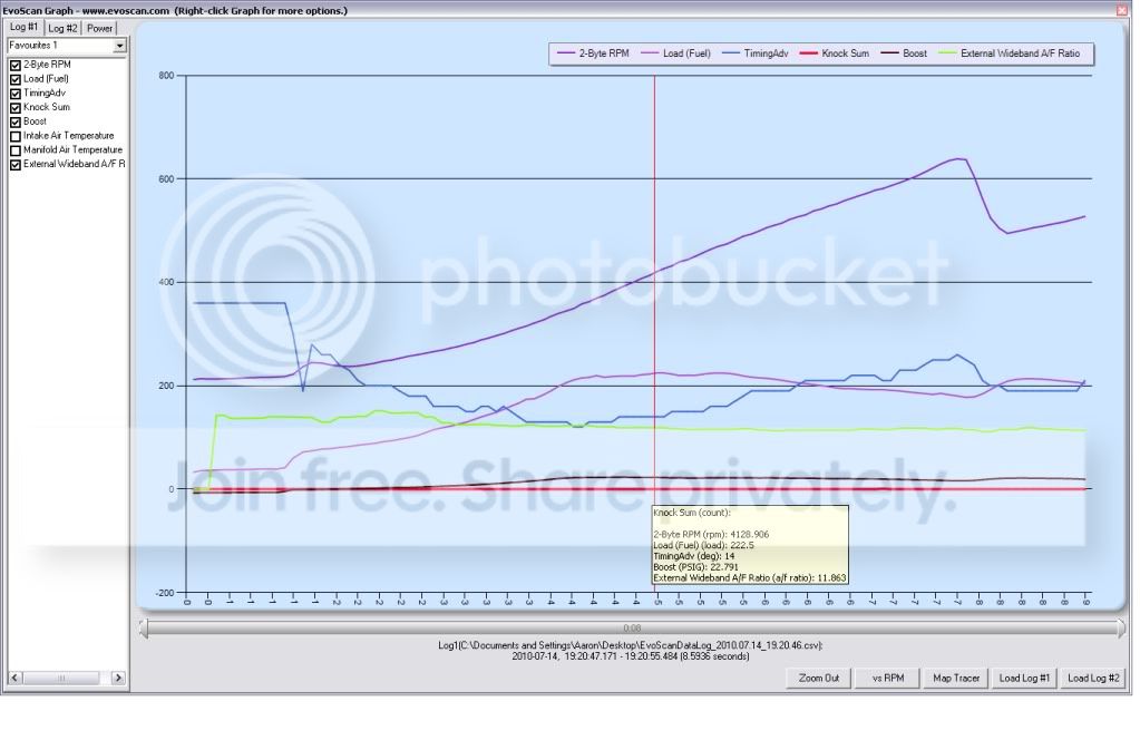

I replaced my wide band and attempted tuning the car for meth injection. I was able to add a good deal more timing. Lot easier to set afr with a working sensor! I also tried the "No fuel trim at WOT" mod. Seems to work well. There is still much room for improvement I'm sure but here is a log I took earlier. This is using a 375 ml/min nozzle. Here's a link to some pics https://www.evolutionm.net/forums/09...8607-snow.html
I think I have the boost error correction set too fast. No boost spike at all and a little jagged. It pulls hard like never before. Now I need to find a supply for the meth rather than buying the premixed stuff for too much $.
Please feel free to voice your opinions.

What have people seen for power/torque using Evoscan? I have no reason to believe that this is at all accurate, but this is what it gave me after a few pulls this evening.

EVO Scan is not very accurate... You need to use VDR... Im still using the 5.71 version and its very accurate as i have compared it to my dyno charts at AMS on there dyno jet. Send me a log of your car on a 3rd gear pull on FLAT ground with only you in the car with your weight... If you have a passenger i will need to know there weight and i can give you a read out that will be VERY close to dyno jet #s.
PS. It wouldn't hurt to do a few pulls to send.

Here is what VDR 5.71 says. I entered 300 lb because I figure my sub box and stuff is around 80 pounds. I gotta smooth that out some. Struggling with the MIVEC a bit!

Whoa turn that smoothing up to around 12-14....

Updated with a pull from this evening. Just the mivec has changed up top. Still can't get that dip out. Tried everything I can think of for mivec combination in that area.
