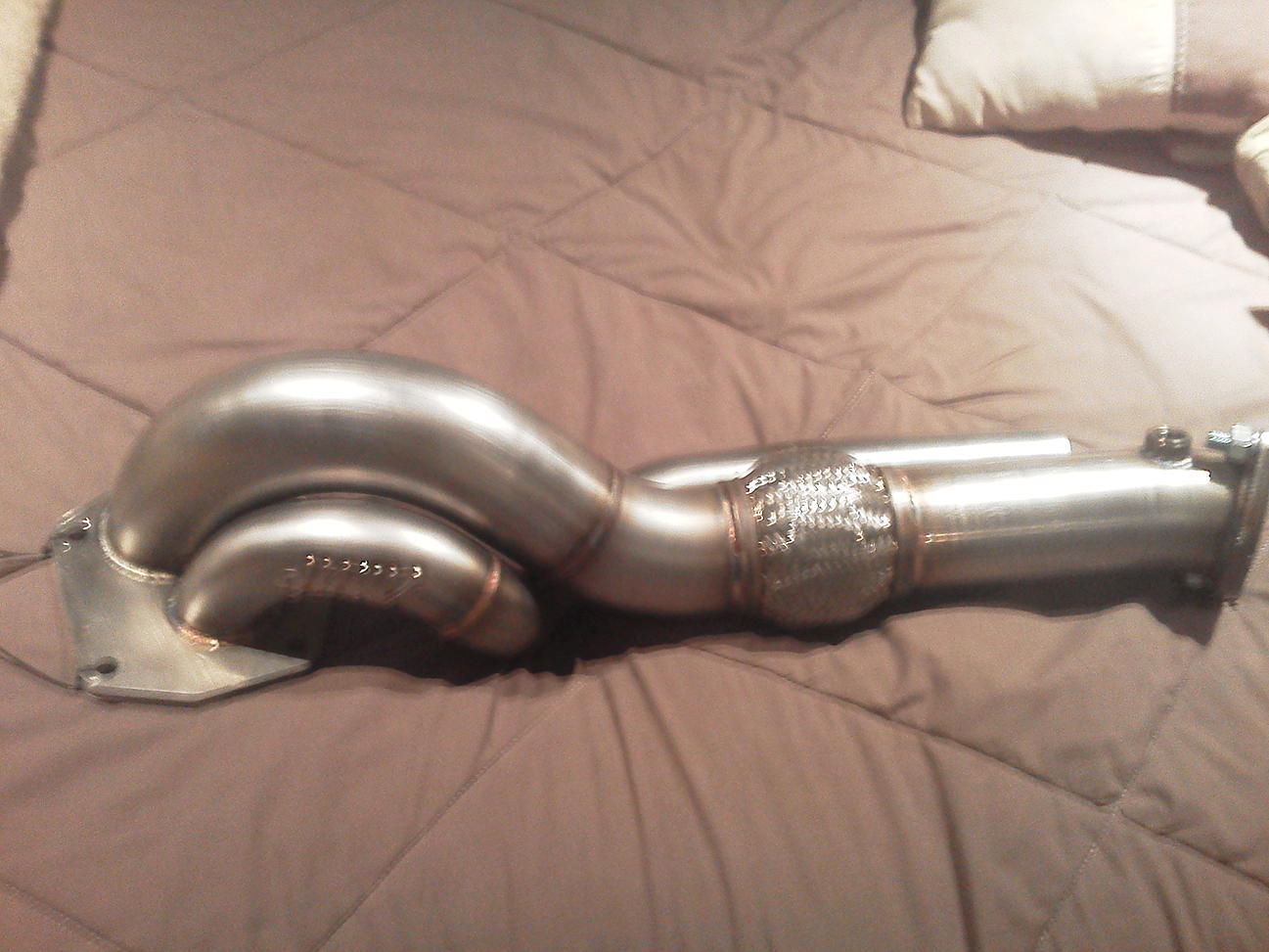

well after a few weeks of waiting for bearings to come in the motor is all back together now. with the new build i happened to also pick up
MAP long runner
MAP downpipe with o2 dump
AMS Tmp cams
new injectors
and i also got my new AMS catback before the motor went

well after a few weeks of waiting for bearings to come in the motor is all back together now. with the new build i happened to also pick upMAP long runner
AMS Tmp cams
new injectors
