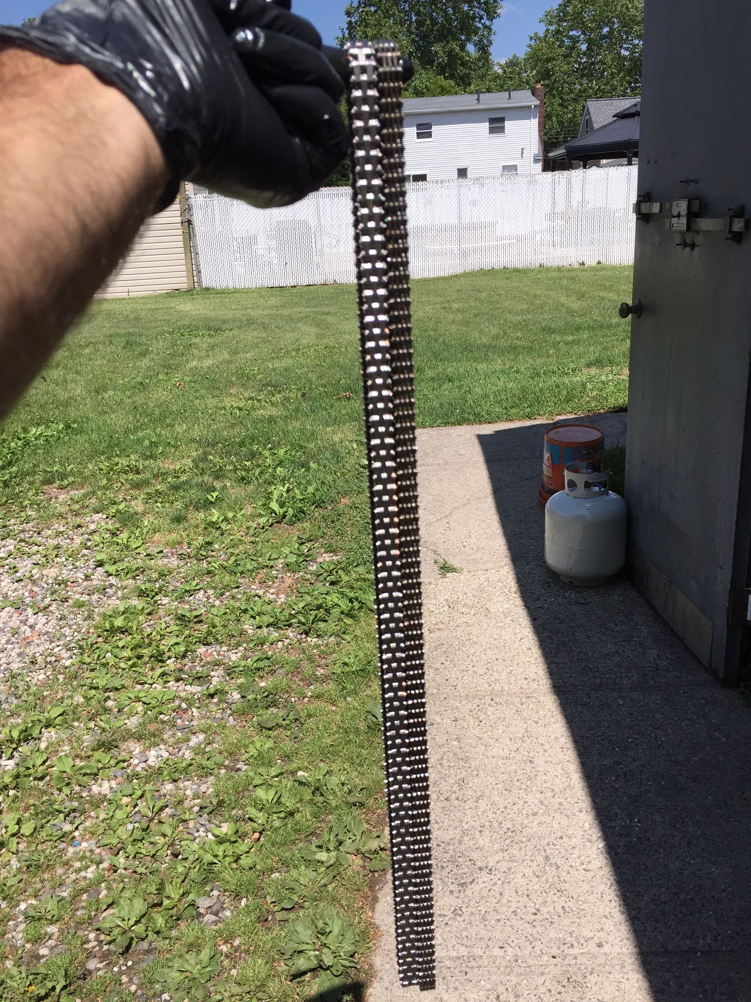

Here's a pic of a timing chain I replaced for a friend who was out of warranty. The new and improved chain is on the left and the old, stretched out chain is on the right.
