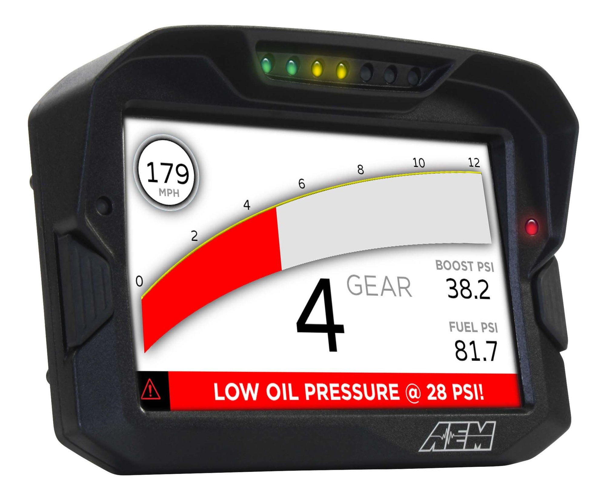

AEM CD7 and CD5 have always been great options but in the last few years the Haltech IC7 dash and UC-10 dash have come a long way. With haltech releasing a software update opening up inputs and custom layout/dash designs these are a hard option to beet. The Motec C125 and C127 still offer the top tier motorsports functionality but they come at a price.
**as of 2025 I still have a CD5 and just picked up a Motec C125 (ro replace another cd5 i sold).
LCD color display allows complete user control of display
CD7 Dash AEM digital display
