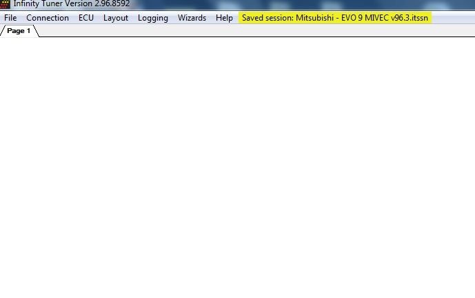

Hello All,
I am in process of getting AEM infinity series 5 for Evo 9 .
I am opening Infinity Tuner and trying to load the base calibration off line but it is not showing.
Can some one assist ?

Try selecting a layout.
Layout > Open layout
or
Ctrl+O
If it doesn't automatically direct you to the layout folder, it's in 'My Documents > AEM > Infinity Tuner > Layouts > v96.1 & v96.2 & v96.3'

Thanks Buddy, it works now.
This software is completely different than what i am used to.
For e.g when i rescaled the Load axis Y to KPA it did not interpolate the map automatically.
