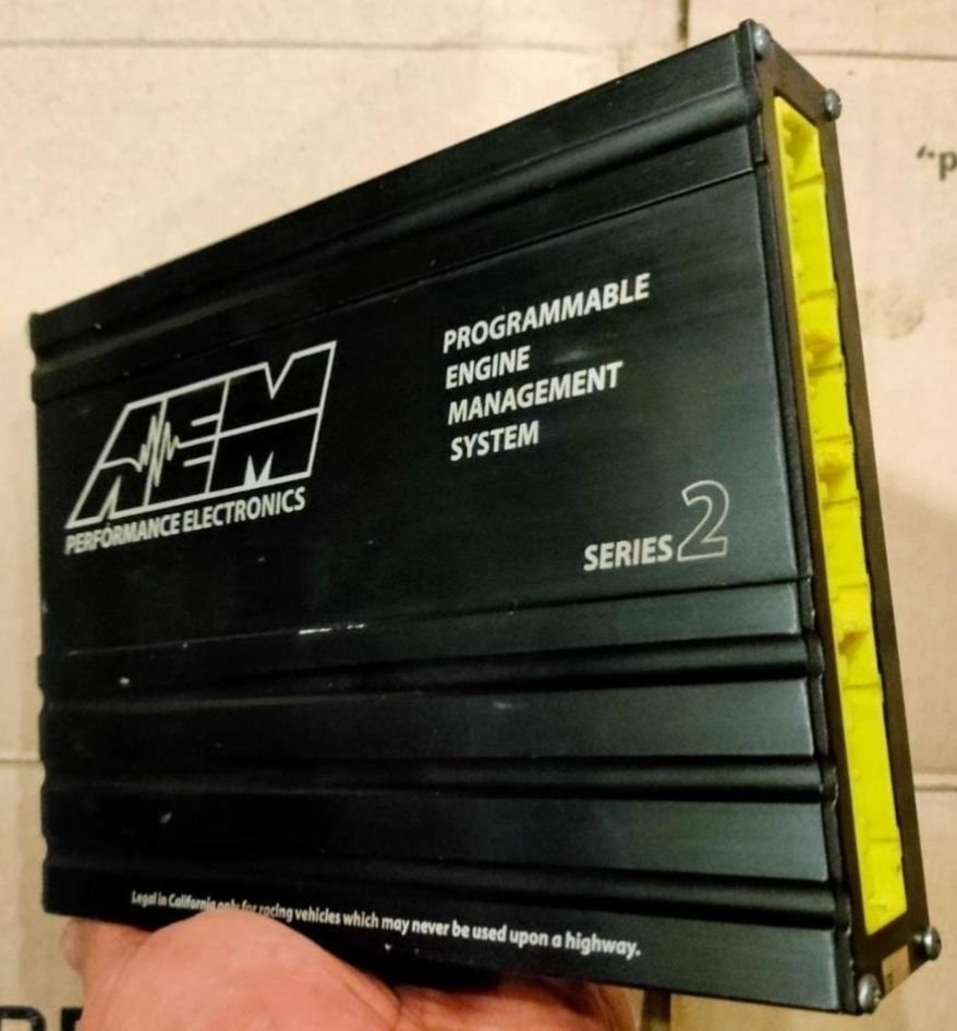

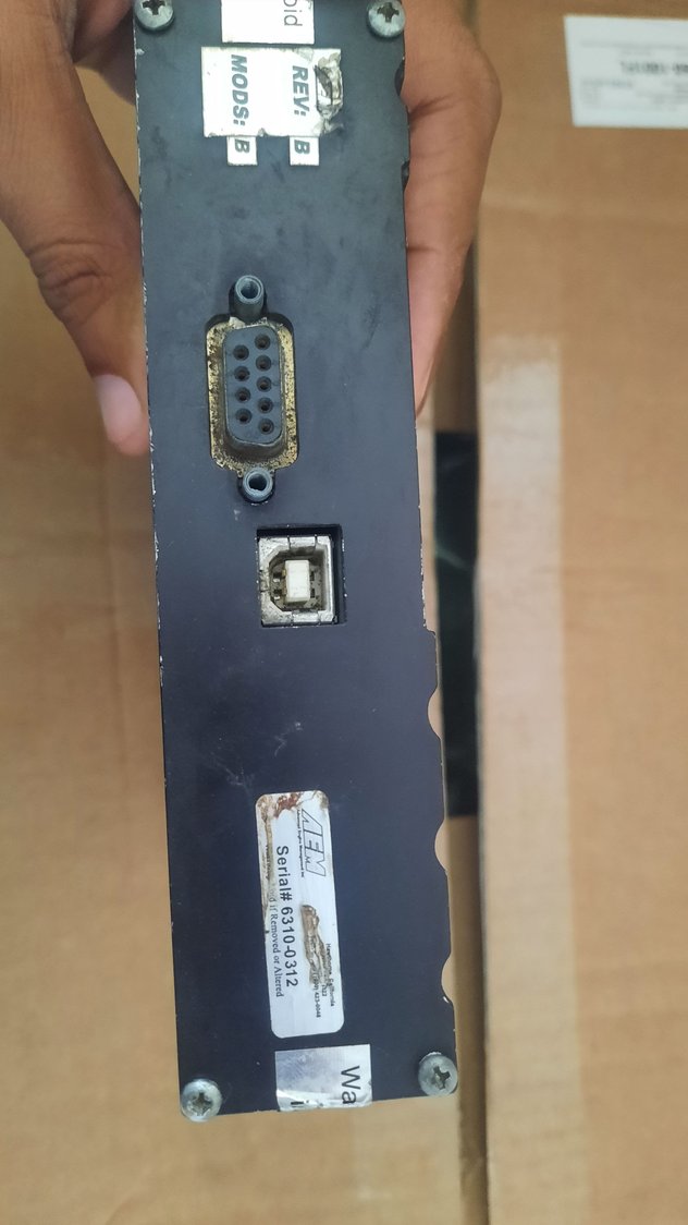

i baught a aem v2 with serial number 6310-0312
( pic attached)
i would like too know if this ecu will work with flex fuel sensor and adjust tables accordingly too the ethnol content for example can it adjust the tables if i use e20 or e85 and everything In btw automatically with timing and boost?
or does aem v2 have any issue running flex fuel sensors with different blends of ethnol content.
would i need to tune just one map for pump and ethnol or is series 2 unable to switch map btw pump and ethnol on its own using flex sensor?
