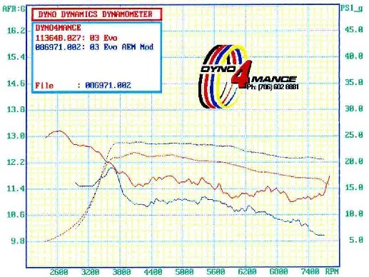

Originally Posted by Boost Solutions
Ryan, you are FORGETTING to mention that silverevo8 was running 18-19psi and PUMP gas with a SAFE street tune,
and you were running 23psi, RACE gas, and a more aggressive map
I hope you understand the difference between apples and oranges, or should I say PORK CHOPS, and HAMBURGERS
Actually, that data is incorrect. Ryan's max value was 22psi, which is in reality less than silverevo8. I was compiling all the graphs at the dyno day, and silverevo8 was running 24psi from 3800rpm to 5200rpm, where it eventually tapers to 21psi at fuel cut.
Unfortunately, I don't have Ryan's graphs here with me at the moment.
I do, however, have my car !!!without cams!!! tuned on a XEDE. I've done an overlay with my car and silverevo8's car. My boost taps 21psi for just a bit, then tapers to around 17psi. This is my PUMP gas map, btw. If I used my race gas map, you'd see my max whp value of 279.2, which would be even more convincing. The XEDE cars used less boost and were tuned much more conservatively regarding boost, but still with very safe A:F ratios and no knocking. Here is my graph and silverevo8's in an overlay if any proof was required. I'm red, he's blue. 93 octane, baby! In the second graph, the air:fuelscale is on the left, while boost is on the right. If I had cams like Ryan or silverevo8 do, there'd be a lot more midrange in my car. As you can see, my XEDE tuned car makes its best power where it matters the most for acceleration, in the high end where the car lands when you upshift.
The point? Hamburgers, while costing less, can still taste a heck of a lot better than pork chops while running a lot less boost!

Here are the graphs.
Attached Thumbnails thank you boost solutions-xedeemspower.jpg   thank you boost solutions-afboost.jpg
Hey Noize, thanks for posting those overlays.... What is very readily apparent is that my car is running rich off the scale.... There is no way that the car can make power like that. Also, the curve does not look right in some respects. This reflects pretty much what the 1/4 mile times and trap speeds would suggest.
my car was falling flat and losing power pretty much in line with the A/Fs going richer and richer. I'm sure that the car is "safe" at practically any boost with fuel dumping like that , Unfortunately, that is not the best way to make power..... With the mods I have in the car, I would expect close to 300whp with pump gas.....
Well, George is going to look at the car again and hopefully get it sorted out. Right now the car is at the body shop getting repaired from the accident I had May 2, unfortunately it developed some sort of problem while at the body shop and it's not starting. However, George is going to go there and take care of that problem as well (thanks George). Anyway, let's all see what happens next and try to keep cool heads and stay off the flame throwers. Fair is fair and although I was very frustrated and discouraged with the previous attempts, I have to give George and Boost Solutions another chance to make things right. For my sake and theirs, I hope George succeeds
