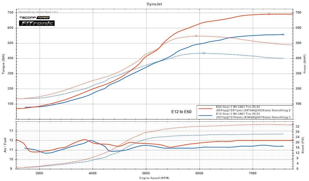

We went to the track this weekend and the best MPH I can get is always around 130. Here is my time slip I'm in the left lane. Car is 2.3L 6466 running 30-32lbs or so on E62. The rev limiter is set to 8000 and I bounced it in every gear so with better driving 10's should not be a problem to hit but I'd like to get in the low 10's or even hit some 9"s to be competitive at the track.

Using the weight in that dyno run, calculator puts you at 600whp.
However, if you are banging off the limiter, you are losing trap speed.

Okay so more like 600whp Mustang Dyno. I raced it a few times now and its always right around 130. I'm sure a better driver could probably get a few more MPH out of it.

I made 617 on a dynojet at 32psi and trapped 138. 6466 stock block
