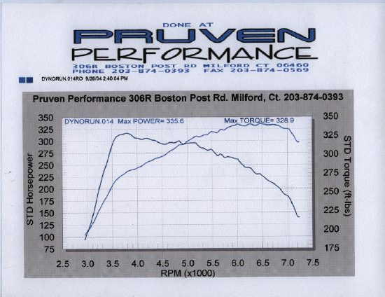

Final sheet - at the end of the tune - it took one hour and twenty minutes of dyno time but the results are very good for the mods done to this car
On the road this car pulls very well - loads of low end trq and a killer smooth power band. Like night and day from when the car first came in and was road tested with its old tune.
Attached Thumbnails Dyno tuning with Dyno Flash - case study - xxblackmambaxx-mamba9.jpg

Final sheet

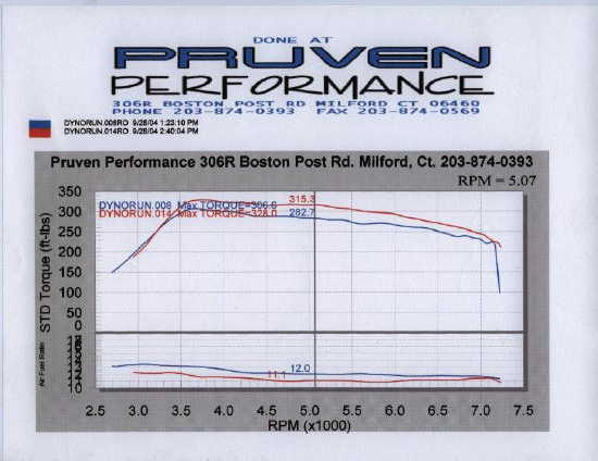

Here is the A - B comparision against the other lean flash and my Dyno Flash - before and after
Attached Thumbnails Dyno tuning with Dyno Flash - case study - xxblackmambaxx-mamba10.jpg

Before and after whp and a/f - note leaner is not always better
