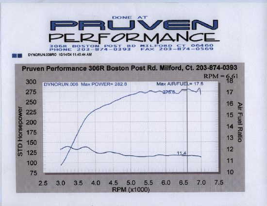

Here is yet another Dyno Flash case study review for the benefit of the potential customers out there to see how we tune and why we tune the way we do
Here is a more stock like car for a change with only a few mods
Stock air box
down pipe and cat back - stock cat
Hallman Pro MBC
Walbro fuel pump

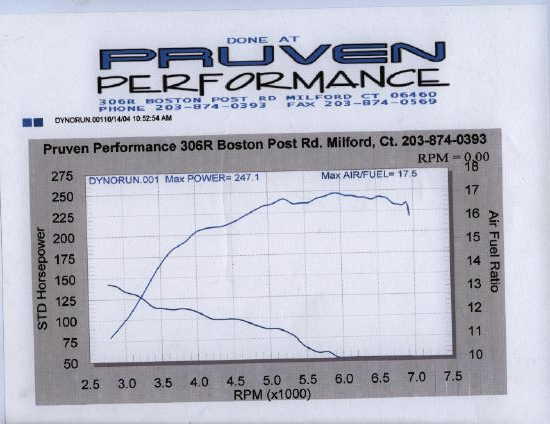

Here is his base line run - nothing unusual
Attached Thumbnails Tuning with Dyno Flash - case study # 8 - Member Number13-131.jpg

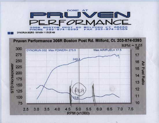

Here is his first run with a base calibration - too rich in the middle
Attached Thumbnails Tuning with Dyno Flash - case study # 8 - Member Number13-132.jpg

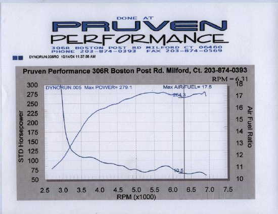

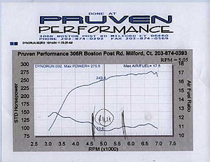

we need more smoothness in the a/f curve
Attached Thumbnails Tuning with Dyno Flash - case study # 8 - Member Number13-133.jpg

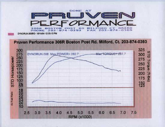

Went a tad too rich - almost done - but its dropping down a touch on top - I feel like I have this car almost dialed in 100%
Attached Thumbnails Tuning with Dyno Flash - case study # 8 - Member Number13-136.jpg

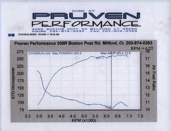

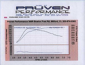

Here is the final sheet - nice tq numbers - a totally smooth power band and man this car was lazer smooth on the road.
We did one pass after this one on the dyno to confirm that the settings held 100% and the road test confirmed that the car was perfectly tuned
Attached Thumbnails Tuning with Dyno Flash - case study # 8 - Member Number13-13final.jpg
