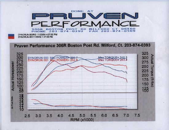

Here is another one of our customers in today with a MR
Amazingly - we had 3 MR's in the shop today !!!!!!!! I love MR's
This one just got the MBC and Walbro fuel pump
This is member Twan - a super nice guy
I was amazed to see 315 ft lbs on 1.5 bars peak boost falling to 1.3 bars
This customer had already upgraded his bov and it was leaking slightly
Big power to be found on the new MR turbo. There is a lot of potential in this new car. We would never have seen even 300 ft lbs on similar mods with the old turbo style.
Here is his car with the stock flash and parts vs. our flash and mbc and pump

What did he have the MBC set to? What kind of BOV did he upgrade to? Very nice work and nice numbers.

He said 1.5 Bar dropping to 1.3 Bar which is like 21.5 dropping to like 18.5 I think.

The baseline was with the JDM BOV only. The final tune was with the JDM BOV, Hallman Pro MBC, Walb Fuel Pump and K&N drop in. Super happy with the tune, the car drives so smooth and pulls all the way to redline now. And if you think about it, thats little to no mods.......still running stock exhaust!
This was on 93 octane with boost hitting about 21 and settling to 19. I will know more acurately when I get those crap sportsmeter gauges outta there and the Defi's in.
Thanks for all your help AL, it seems like only yesterday we were BS'ing at the 1st Dynoflash day way back at Pruven. Good work on getting the 05 flashes ready. I appreciate your work today more then I could have told ya in person, so again thanks man!
