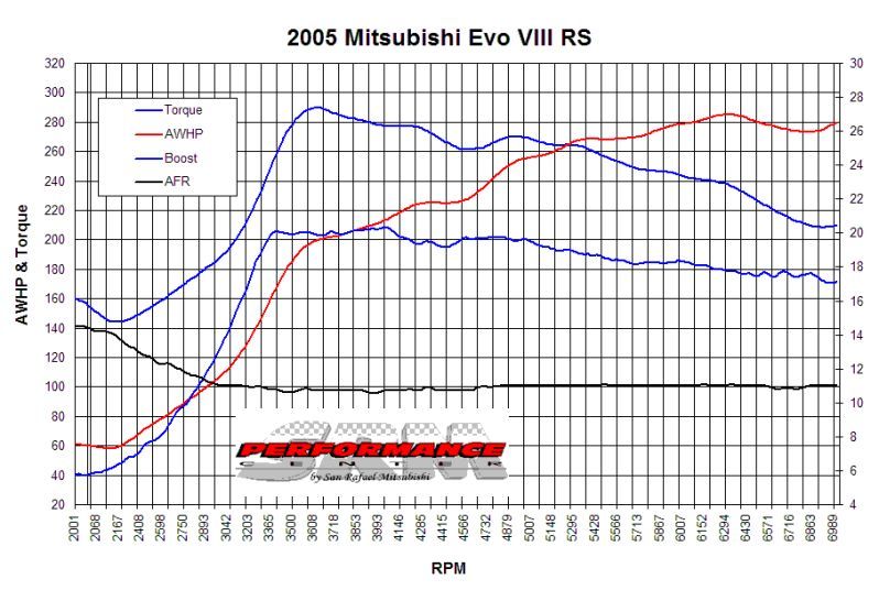

Also, my dyno chart really drops off at about 6500 rpm. I've noticed the stock cars do this as well, while some of the posted curves do not? What causes this?
Here is the dyno plot for reference

Which stage Buschur Flash are you running ? (The boost you are running is falling off a bit up top - should be holding 19 psi) Let me know what the mods are

Buschur stage 3 + fuel pump. I'm using a MBC, but it seems to fall off. I've ordered an HKS EVC. I've pressure tested everything, found that the 1G BOV was leaking as well.
Where do you live ?
Something is very wrong with your set up its down at least 40 whp.
Try slightly crushing the mbc. I would be willing to bet you hav eother boost leaks. The Buschur MBC is a very god unit and usually holds much better boost. On a stage 3 a peak of 22 psi falling to 19.5 - 20 psi is ideal and will yeild a lot more power than 17 psi.
Also - check your cam timing.
The a/f is dead on the through the mail flash target so the tune is close.
Old Mar 24, 2005 | 05:14 PM
bracer's Avatar
Posts: 134
From: Cotati, Ca
I live in Northern Ca. (1hr north of SF). Dyno was before the BOV fixes. BOV was leaking pretty big. Cams were installed by SRM, so I think they got it right. I took the car out while on racegas with the wastegate disconnected. I would slowly bring it to 5000 and then floor it. The car would make a maximum of 19psi at redline. With the BOV fixed it will now make 22psi at redline. I crushed it and did the Dejon Tool modification as well. The MBC still tapers 3 psi though. I havn't dyno'd it since. As soon as the new EVC comes in I will dyno it again. I'm sure the numbers would be higher now. I think the tune is right on, but like I said, what would be gained going to a race gas flash?
