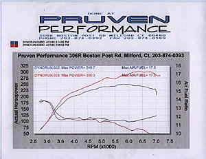

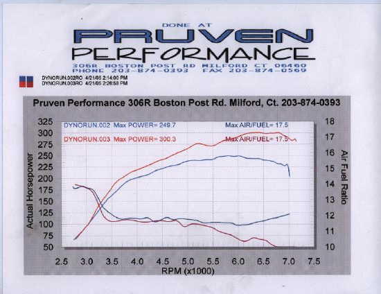

Here is the extreme effect the silencer had on this car - first run WITH silencer and 2nd run same exact settings with the silencer removed
its a 50 whp loss ! I dont think I will be using a silencer any time soon

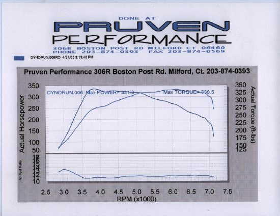

First pass with through the mail Dyno Flash

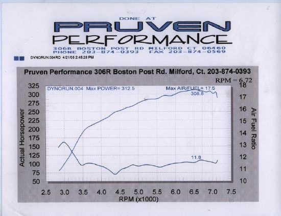

Adjusting the a/fd - flatening things out but too lean - more adjustments to come

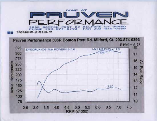

Here we are getting close
Good power for stock intake

Frankly I never thought that the silencer would have this much of an impact. I would have expected gains of about 20 - 25 whp - 50 whp totally suprizes me
