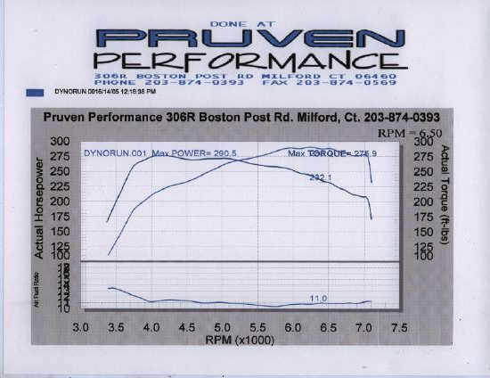

This today's 1st mission on the dyno
BR Alcohol kit
Tomie cams
3" exhuast - high flow cat
cone intake (dirty)
upper fmic pipe, stock fmic
Blitz SBC ID EBC
Walbro pump
93 Octane fuel
O2 housing
This car comes by way of another tuning house that had tuned a UTEC on thsi car and I dont know how it can be making such low power with all these mods
The customer came down to me after having had a lot of frustration with no having his car run properly and having a lot of detonation and rough running
I am going to now remove the UTEC and see what I can do with my flash tuning
Attached Thumbnails Case Study number 56 - Robs - weak ass tune with alcohol-case56.jpg

The AFR's are 11.00 which is good. Maybe the Utec tuner got confused and retarded timing instead of adding it .

Testing the car with the base flash we only net a few tq - obviously something is wrong
A quick boost leak test shows that the car is leaking boost like mad down underneath the turbo
Pulling the car in the air we can see the turbo discharge pipe is leaking
The turbo discharge pipe - Helix - is warped and distored by a large degree creating the significant boost leak
We will also test compression and can timing before we put the car back on the dyno
More news later

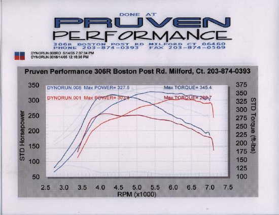

Compression good, cam timing is perfect - a new set of BR7ES plugs and here we are
1st tune vs final tune with Dyno Flash
Attached Thumbnails Case Study number 56 - Robs - weak ass tune with alcohol-case562.jpg

muhahhaa look at that torque spike. I love the stock turbo with alcohol!!!

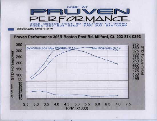

Final sheet is here
Remember - tuning is only half the war - careful parts installation and watching for boost leaks is key
(Also this guy had a very restrictive fujibitisu exhasut with two resonators and cat b/c he has small children)
Attached Thumbnails Case Study number 56 - Robs - weak ass tune with alcohol-case563.jpg
Old Jun 14, 2005 | 04:41 PM
Jon H's Avatar
Joined: Dec 2004
Posts: 330
From: San Luis Obispo, CA
Was he still experiencing problems? HP seems low for that set up, but the torque looks about right.
His cat and very restrictive exhuast are no doubt restricting the flow up top
Also - today was one of the hotest days ever here and all cars were down on power
