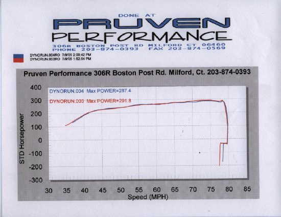

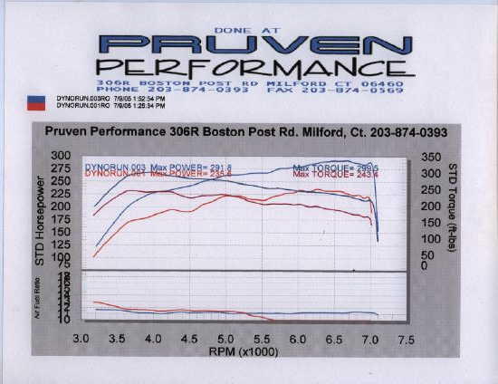

Here is member thedriver11421
Injen Intake
Walbro Pump
3" exhuast with cat
MBC
Dyno Flash
Not the most power ever made - Due to cat - but a very smooth sheet and a big pick up before and after on the tuning - a pleasure to drive

hey AL, WHAT WOULD YOU EXPECT THAT TUNE TO BE ON AN 03 8. PLUS WHAT ARE THE NUMBERS I CANT SEE THEM ITS BLURRY. THANKS

Is this on 93?

This is what you want to see when your tuner is doing tuning - two runs back to back - virtually identical curves - this is what we call repeatable and consistant (zero knock)
This car was 05 - 93 octane

so thats a 56 hp gain from just an intake, cbe, fuel pump and flash? Jesus!
