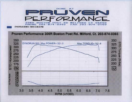

Here is a car with
Injen Intake
3" exhuast
Walbro Pump
Hallman MBC
BR Alcohol Kit
Dyno Flash custom
I love the curve on this car, not the most whp ever made - but it was a very smooth - very nice running car on the road. its 95 degrees on the dyno here today so the numbers are a tad low. A very good quality tune.

This is the same car in case study #61 right? If so, that is a pretty impressive gain with the alky kit- 30WHP and 22WTQ

Dont think so doesnt say that they have the cat on this one. unless its been removed

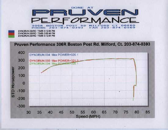

Different car than case study 61 and this is a 03
Torture tested back to back runs
The pulls stay identical - a very importnat point to test

This one has a high flow 3" cat - test pipe would pick up a few more
Driving this car is sheer bliss
I just picked up another new customer who was here for a little gathering after this car's owner took him for a ride in the car its intoxicatingly smooth and linear

I'm surprised that it didn't richen up with coolant temp elevation on back to back pulls.
How much boost was this car running?

The runs were 4 mins apart which is just enough time to normalize the collant temps
This car was at 23 - 24 psi peak falling to 20 psi at red line
