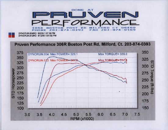

Case Study # 76 - ATP 3071 vs. 2005 stock
Mods - 3" exhuast
660 injectors
Stock air box, stock fmic , stock fmic pipes
walbro pump
HKS 264 cams
Hallman MBC
Custom Dyno Flash
Before is ATP 3071 turbo bolt on
new run is with stock 2005 turbo
as we can see much more tq and low end power with stock 05 turbo
all runs on pump gas 93 octane

Wow, I wonder why those ATP kits havent been getting good reviews?

Weren't the runs on the 3071 with stock cams?

Good point - I did not think of that ! I am sure he did have stock cams before

Got home 4 hrs ago and felt a sleep at the door step ...
The car is a joy to drive on the way back but suddenly I got a boost leak (I will fix tonight)
The ATP kit had no cams on that dyno sheet so the compare is not apples to apples.
ATP does make power period but you loose TRQ for sure.

So had this car had the cams with the ATP kit, there would be no comparison.
Not to mention 344whp is pretty impressive with only a 3071 & exhaust.

He had no cams in with the 3071 which would make a 20-30 hp difference.
Never the less the power is nice with quicker spool up.
