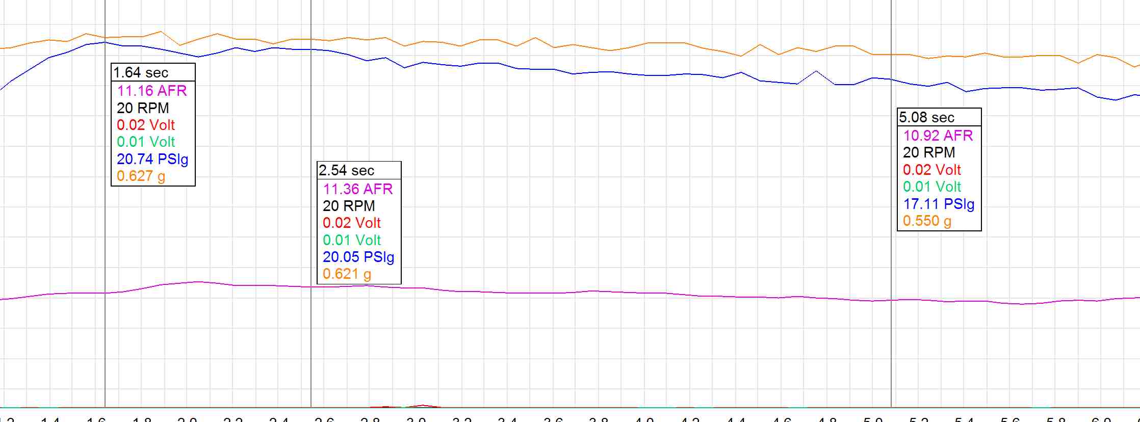

Guys - tuning here in sunny FL - spent two days finalizing the details of the new "V4" boost controlling flash - here in a bone stock 2006 Evo IX
This new product includes a reflash (custom or through the mail) and a propietary Boost Hose which has a revsed boost pill configuration
I spent a lot of time with David Buschur perfecting this arrangement on the BR350 car and now I have it working OEM quality on the 2006 IX
The boost peaks at just over 20 psi and tapers to 18.5 or so
The boost holds the same in all gears
As you can see from the attached log the quality and results are near OEM quality - in fact it works much better and smoother than the OEM controls
It took a lot of work - but the results are superior to a MBC or EBC at this point as the oem ecu continues to have the ability to lower the boost level while you are warming up and when and if you may pick up a bad tank of gas to protect your motor.
For the time being this is offered ONLY to STOCK EVO IX's only - I will have it woking on modified cars in a short period of time

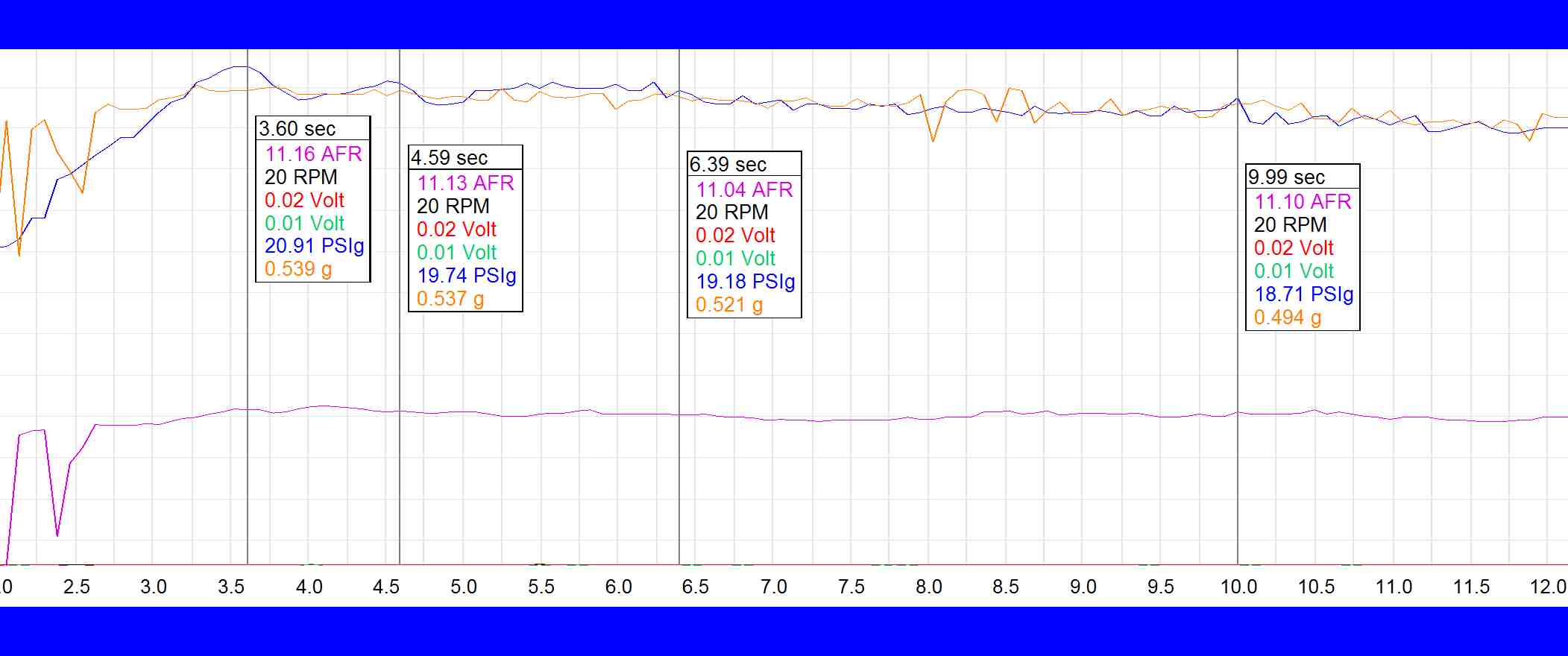

The previous pull was in 4th gear
Here is same car witha 3rd gear pull - the boost hits same point - falls down a slight bit more
Main thrust is that its smooth - linear and works amazing in all gears

The G meter was not flat to the floor qwhen I was taking out the equiopment adn thus the number was prob a bit high - none the less it was a very fast car
The Evo IX stock with this flash and boost hose is almost as fast and many 2003 Stage 3 cars - the IX's really are amazing cars

Very nice work Al. Glad after all the work you have it working so well. That's about as flat a boost line as it can get.
