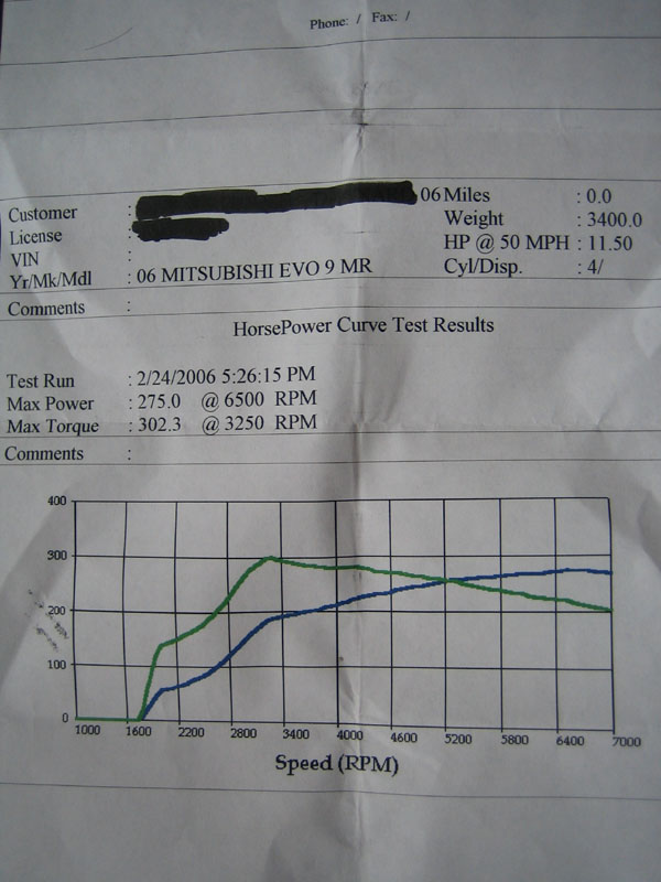

Anyway, this is my bone stock baseline run:
and here are the post dynoflash + mbc results:
I'm getting the expected torque in the midrange as the boost reaches it's target peak but then i'm losing power in the top end due to the extreme boost taper

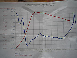

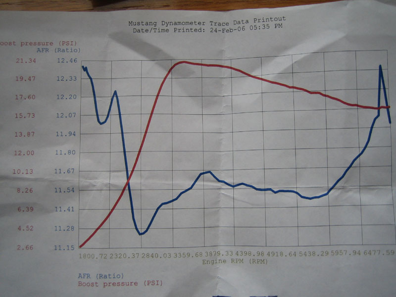

Here's the Boost + AFR plot from the above run:
Note that I also have the high rpm leaness that cij911 saw after his flash ...
Looking for thoughts on why I'm not holding good boost ... and the AFR looks a bit scary to me ...

What is interesting is that we seem to both be hitting peak torque at 3250 RPM, but your boost is at peak and then starts tapering, whereas mine does the first spike then dips a little and then peaks again at 4700 RPM and then falls to ~16.88 PSI.
You are making making ~14 ft-lbs of torque more than me ....If only I could get the better spike and then both of us have a slower / better taper. I think with both our setups it is the MBC and we should go back to an EC BC.
Are others experiencing the same problem? Also, we both are running stock exhausts.
Chris, here is your boost/afr plot:
You are actually tapering to about 17.8 right before the operator let off. That last drop down to 16.88 was after he let off the gas.
So you're holding a bit more than 2 psi to redline, which explains why you are pushing 25 more whp ...
As for the 14 ft*lbs of torque comment ... it's only for a brief spike of the turbo boost, then my turbo quickly tapers more than yours and you're pulling away from 4500 to redline ...

What's with those AFRs climbing to 12.0:1 up top? Are you guys running out of fuel?
It looks like as the boost is falling down to such a huge extent when they approach 7,000 rpms the load referenece is dipping into a partial thottle mapping area
Not to worry at 15 psi they wont have any problems
When they get a decent boost device that holds 18 psi at the top end the a./f will flatten out
Old Feb 25, 2006 | 10:49 AM
RazorLab's Avatar
Posts: 14,094
Likes: 1,093
From: Mid-Hudson, NY
the 2nd guy has 18psi and 12.0:1 AFR at 6880rpm. I dunno, it just looks like he is running out of fuel or injector because of that sudden spike in AFR.
btw, I am not talking about your tune at all.
It is possible
There were both base flashes
it is also possible that he had a mis fire which can create a similar blip in the a/f chart
I was not there to do the dyno or a/f testing so i can't comment
Bost base flashes appear to be working well on the dyno they just need to sort out the issues with the boost control and the cars should be running well
