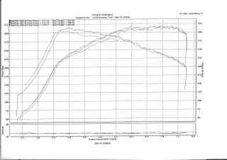

Got my car dynoed at Topspeed in GA. Mods are in my sig. boost set at 21psi, 93 octane, mail in flash from "dynoflash"
Topspeed uses a dynojet but Doug told me that his dyno reads lower than other dynojets.
First run: 317hp 313tq
2nd: 315hp 306tq
3rd: 319hp 310tq
What do you all think?
Here is a link to the dyno
https://www.evolutionm.net/forums/at...entid=99175aph.

ohh can someone tell me why the line on the HP is nice and smooth on its way up but then kind of bounces around up on the top RPM? I dont know what that means...thanks
It looks normal for a dyno jet to me

I would say that you should test your autometer gauage your boost is down nearly 2 psi

i'd say its a lower reading dyno..you have similar mods to me and i put down a little more power. its good power though, especially because the tq and hp are so close.
I will turn it up some and see how it responds.....can you tell me though how you know this, i am sure that you can tell by looking at my graph,but i am curious. Thanks again Al.

I would venture to say he is taking a guess because your power is about 20 whp below average for your mods. I would test your boost gauge to see if it is accurate before you just go turning up the boost. (not the greatest of ideas)
A custom tune on a dyno/street would probably yield you some more power

thank for the smallest dyno chart that no one can read. but you know what you can still see from it? its a decent tune, you HP comes on very liniar.. looks good

It was just a mail in flash...i turned up the boost some and the car feels alot better now...it spikes to 23 and tapers from there. Under a hard load pull in 4th it did spike to 24psi...but the car as a whole feels alot stronger.
