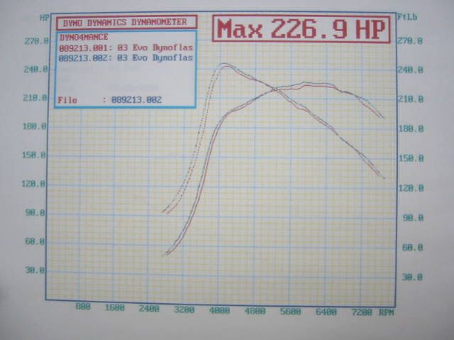

My DYNO Results with Fireball 2
I got 226.9WHP with mail in DYNOFLASH and full-exhaust with 93. A stock EVO has around 187.9WHP. So as result I gained about 41WHP and 45ftlb torque for $1300 with flash. There was stage 0+ of Event Horizon with similar mods to me that got 243WHP which is 16WHP better than my car but he had a custom tune with 10 plus runs.
In the end my $200 flash delivired results I am happy with.

nice gains, throw in an MBC ($50) set at 20psi and you should be at 250whp on that type of dyno

All those mods and only 226whp? Do you have your A/F printout Snoop?
My car only put down 200whp with CB exhaust, K&N drop-in and Dynoflash Mail in, and I was pretty bummed to say the least. Especially considering right before my car ran a Stock EVO put down 220whp.
Why the hell do Dyno Dynamics Dynos read so low?

A stock EVO does 187WHP. The estimated WHP is 290
Look at the chart.
What is more important is how the car feels and powerband.

Located North Georgia with 80 plus degrees, humidty, High elevation. The owner shop Andrew states the dyno read 185-190WHP.
Dynos are different
http://www.dyno4mance.com

Right, I know dynos are different. The one I went to, and the one you went to are the same type of dyno though, Dyno Dynamics.
Here's where I went:http://www.dyno-comp.com
At Dyno-Comp, Vivid Racing's stock EVO put down 232whp.
I witnessed myself, a stock EVO put down 225whp at Dyno-Comp.
Following that car, my car ran and put out a measly 200whp with roughly $900 in mods.
I am just wondering why it is that my car has less WHP than other cars around here. $900 in mods got me -25whp.
I hate my car.

Those kind of dynos can be manipulated and you can alter the numbers by changing the settings
Thats why I prefer the dyno jet for whp comparision as there is nothing to change

More correctly, any type dyno can be easily manipulated. Dyno4mance certainly was not. Dyno comp's DD is known to read higher than Vishnu's, which reads higher than Dyno4mance.
Remember when cameras had lux ratings? There was no industry standard. One camera company had a totally different scale than another. The same is true with all dynos. You'll see some dyno dynamics systems that are more ego friendly: Dyno comp, and ones that read lower: Dyno4mance. The same is true with dynojets. Pruven is really high, where Alamo is a little low. Even Dynapacks. TurboXS reads higher than any other dyno I can think of inthe country, while Knowledge in Woodstock, GA is a heartbreaker.
Snoop is right. His car is not low, the dyno just reads lower than most of us are accustomed to seeing. For the best accuracy and comparison, you can only compare cars run on the same dyno. I put down 301whp at Alamo, and 263 at Dyno4mance.
I hope you find this technical information helpful.

An important point to remember is that the $199.99 Dyno Flash uses stock boost
Any comparsision to an Exede based tune is not relevant as the Exede can alter boost
A better comparision is to compare the Dyno Flash with Buschur MBC - total outlay like $260 which can hold 19 psi to red line
A better compardison would be a base through the mail Xflash to a off the shelf Dyno Flash
The full custom Dyno Flash usually picks up a significant amount of power over the through the mail flash
Becuase of the significant car to car variance and also due to the variance in fuels from location to location, when tuning through the mail we muct detune the maps significantly - expecially in the upper rpm ranges in order to keep them smooth and maintain a significant margin or error
