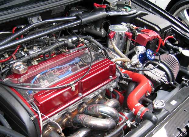

I recently just installed a Dual Port BOV by Turbo Smart(Thanks, AL). All I can say is this BOV is IMO the only one that worked perfectly for my setup. No stalling, no surging, and is tested to hold up to 30psi. My only concern is how loud it is!!!
BTW, this setup is half recirculating(Plumbed back) and half VTA(vent to atmosphere). They do provide you a blank plate to block off the trumpet port. Maybe I'll try it if I don't get used to the sound.
