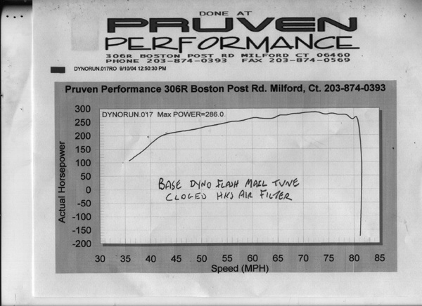

#1 - due to my own negligence, my air filter was extremely dirty and clogged.. I failed to realize this needs to be cleaned/replaced every few months- Ive had it in for about a year and never cleaned it or replaced it. Here's the dyno run with the clogged filter:
After we replaced it he did a second run:
Finally he did some fine tuning and did a final run:
The hp my car is making is just fine. The clogged air filter definately did play a role, after we did the fine tuning we took it out again and the car definately pulls very strong.

So, you gained 2.8hp by replacing the filter with a clean one and it smoothed out the curve a little bit...or am I not reading it correctly

i'm confused as well. Also have you ran atthe track yet to see if your times improved. Based on my previous drag racing experience the 5hp u gained will not get you very much if not any gains in your times... maybe im missing something?

hmm, a fine tuning and a clean air filter, netting 5-hp doesn't sound like much.

The point of these dyno sheets was that nothing was wrong with his tuning or engine which contributed to his sub par 1/4 mile reports, which had me greatly alarmed. The reflash through the mail for the HKS RS kit is probably our best product and I wanted to find out for myself first hand WHY his car was going slow slow at the track.
The first pull with proper boost on the dyno showed a NORMAL and expected mid 280 whp number - EVEN with 30,000 plus miles and a totally black clogged intake filter.
We installed a new foam element and re-pulled the dyno and the number was 286 to the wheels which is clearly within the range of what we advertise for the through the mail reflash and the dyno sheet was most impressive with a totally smooth and linear curve.
I felt that his a/f could use a little adjustment to even smooth things out even more and I tweaked it with one adjustment and yeilded 291 to the wheels with a almost perfect dyno sheet.
Given his slow times we wanted to verify that the reflash was working properly and it most certainly was. If we had given him a full custom tune he prob would have made another 5 - 10 whp - maybe not.
When I test drove the car - I discovered that the 3rd gear syncro was totally shot - possibly due to issues with the very poor disenagement of the clutch he was using. I forgot to ask if he had regularly changed his transmission fluids which is key. Obviously the bad shifting action on the 2 - 3 shift is impeeding his 1/4 mile times.
