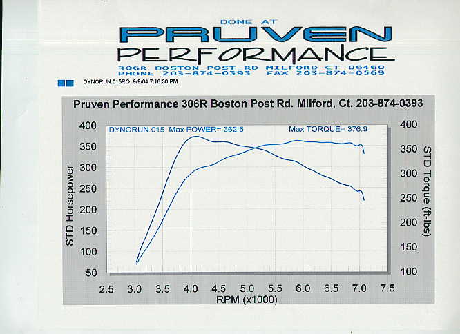

Guys - here is my latest inovation in reflash technology - the Fireball 4
Applications - high octane 100 unleaded or better
Here is a recent example of this reflash on the dyno
Mods - HKS RS KIT - HKS 264 cams - Walbro Pump - 3 " exhuast - MBC
(STOCK PARTS - turbo, fmic, fmic pipes, injectors, fuel rail, engine - except cams).
Basically we have figured out some ways to unleash much more power from the stock ecu and mass air flow sensor and here are the results
This version of our through the mail and custom tune works in this manner.
Option 1 - use high octane fuel all the time - 100 octane or better
Option 2 - purchase a used 2nd ecu from a wrecked evo or but one new from us at dealer cost (about $650). Have your key codes and imobilizer codes programed into the ecu (delaer service) and then you will have TWO SEPERATE ecus that will run your car. You simply swap them back and forth depending on the gas you are using. We provide you BOTH tunes for the same $199 for the mail in flash - OR $500 for a fully tuned custom reflash with both the pump gas and the race gas tune. In other words - the Fireball 4 tune for high octane is free along with your Dyno Flash on your primary pump gas ecu. If you can find a 2nd ecu from a wrecked evo at a reasonable price then you can put the whole set up together for a very reasonable price.
This Fireball 4 is ideal for the sportsman user who does ocassional road racing or drag racing but still uses the car on a daily basis
Here is the dyno sheet - we are approaching the potential of full stand alone systems with the stock ecu and with stock like driveability

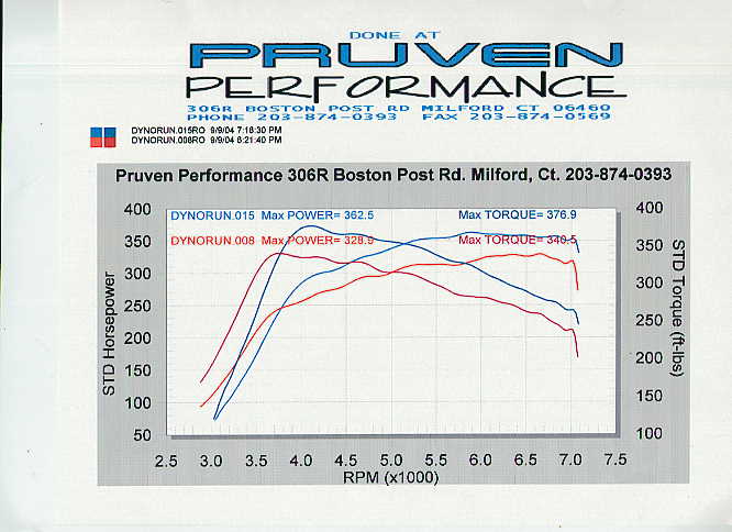

Here is Fireball 3 (pump gas) and Fireball 4 (high octane) on the same car - same day
With Dyno Flash - now you can get both tunes on your car for the same price and be able to run either pump gas or race gas
ONLY Dyno Flash has the technological inovation to unlock the secrets of the factory ecu code and make this kind of power on the stock turbo and fmic - IN A SAFE MANNER
