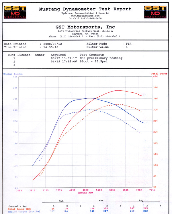

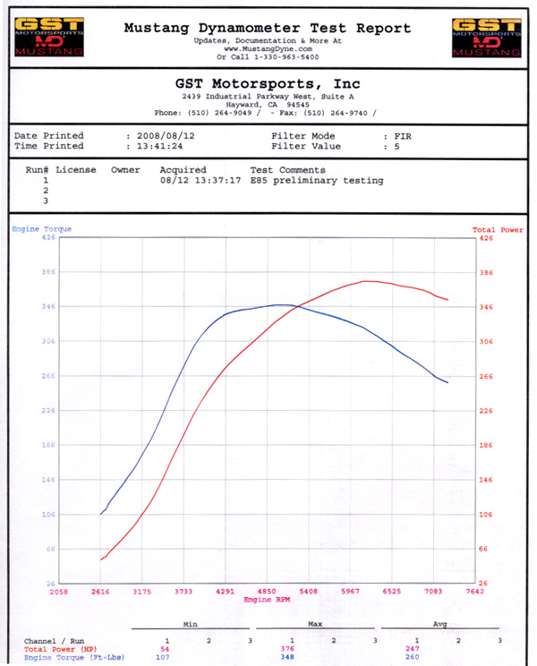

Finally got some time with E85 as the first bay area pump finally opened up in Concord, CA.
So far I am very impressed with it.
I didn't go crazy on the boost yet, nor did I do a ton of experimenting with different AFR levels. I just wanted to use the time I had on the dyno to get a "feel" for the fuel. I also ran into some ignition and wastegate actuator issues that I want to take care of first before I push this fuel harder.
It was pretty warm and muggy in the dyno room, intake temps where 99-101F so not the best conditions. I think the cooling properties of E85 really shined in these conditions.
Here is where I left the tune so far. Peaking just under 27psi according to my logs, about 22psi up top, which is less than what I ran on my crazy "biggie boost" 91 octane tune.
Here is that tune compared to what my Evo did on a more "normal" 25.5psi 91 octane tune a little while back:

Damn what a difference. Might be able to get the torque up more because of the ethanol cooling, I would venture to guess.
