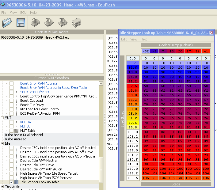

Look at my 96530006 ROM, my stepper table is based on COolant temp. Also what Desired ISCV table did you adjust or all of them?
I have attached a pic of what I am looking at.
Mine is based on coolant temp as well. (it says throttle position, but dont pay attention to that) Different ROM's have different engine temp scales, yours is from -32 to +41 C, mine is from -32 to +82. It doesnt matter. What matters is where the ISCV value is picked from when you try to start the car and have issues. Im my case it was in a 110 row, 2 right most columns. So once you figure out where it is, my guess is just like mine it's somewhere in the middle right part of that table, increase those values by 20-30 and smooth them out with the rest of the map.

I got ya. Try something similar to this:
