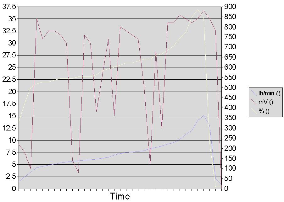

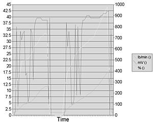

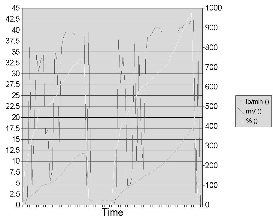

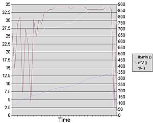

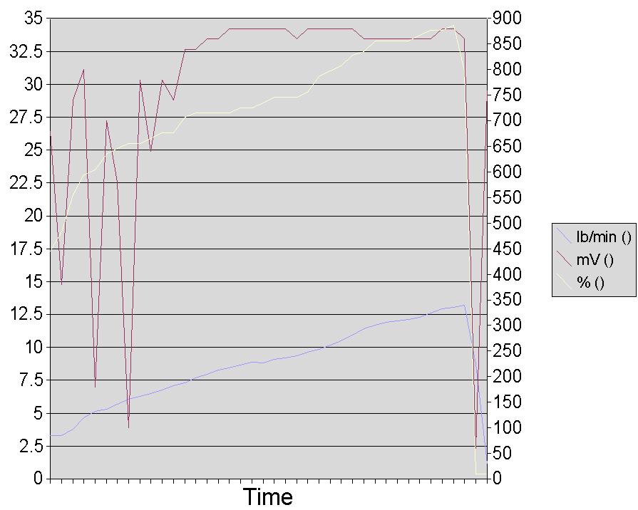

Old Jul 13, 2006 | 05:18 PM
AutoXer's Avatar
Joined: Dec 2002
Posts: 804
From: Logan, WV
Originally Posted by AutoXer
I'll do some logging in the next day or so and post the log graphs.
As promised.
I was getting a crappy data rate.... about one set of data every half second. I think you can see where it goes open loop though.
Attached Thumbnails Open Loop Load & Open Loop Throttle-openloop.jpg   Open Loop Load & Open Loop Throttle-openloop2.jpg   Open Loop Load & Open Loop Throttle-openloop3.jpg
