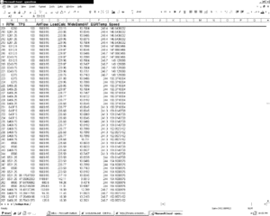

I had what felt like very mild fuel cut or maybe it was mild boost drop at around 150mph once... after changing the boost limit settings and my boost maps etc, it hit 165 and still had a little left with zero restrictor. It took a lot of room to get there. If I would have had my mirrors folded in it might of hit 170 or so given enough space. My STi has a very distinct fuel cut at around 147.
Here's a data log blip from a high speed run; not a 160+ run but close... still revs left.
