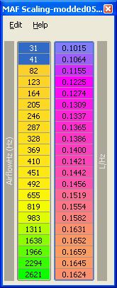

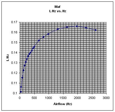

OK, I wanted to start a thread on this to get input from everybody on what they think. I spent the last day or so making a spreadsheet based on data from the DSM-ECU list and the DSMLink forums along with the data from my 05 ROM for the Maf scaling table.
My spreadsheet is called Evo Maf.xls and it is a bit of a long read and tough to understand if you haven't seen the data before, but I'm hoping that some more people can jump in and provide feedback. My point for doing this was to get our Maf scaling table scaled correctly in ECUFlash so that people can easily tune aftermarket intakes, filters, or any other mod that may alter the MAF's airflow reading, and thus calibration.
There is still a lot that I need to learn, but I am hoping that others can help. I know that MalibuJack and awdgsx have already done a lot with the tables and their scalings.
Attached is my attempt at scaling and explanations for them. My spreadsheet is Evo Maf.xls. The others are a couple that I used for my analysis and I have added for your reference.
A couple of pictures from my spreadsheet:
Maf curve using Hz and L/Hz with preliminary scaling
New scaling shown in Ecuflash
EDIT: Post #54 has the newer, updated spreadsheet with the correct scaling for the table shown above. The Hz scales to 1600Hz.

Don't forget to include what your new scaling is, maybe a snapshot of the scaling dialog box for it..
Most don't have the correct scaling, and the new values will confuse them..

Oh and the AirflowHZ value correlated exactly to the MUT conversion formula I used for scaling.. Therefore I'm fairly certain that the left column would be in HZ (as if that wasn't already known)
The big issue is the relationship of the MAF SIZE parameter, MAF Scaling, and MAF Smoothing..
Also, in your spreadsheet you compared the plot you did, with data from a flow bench, the flow bench numbers are a good example of the anomolous reading you can get when you don't flow test the entire induction setup from airbox to intake pipe, and just the MAF itself, as at a particular frequency, you get those anomolous readings..
That graph validates my observations of aftermarket cone filters and intakes that tend to run a bit rich down low, then lean at the midrange, then a bit rich again at higher RPM if airflow could actually read over 1500hz (which it generally didn't on a stock car with an aftermarket intake and open element filter)

Once I get a little more time and we can nail down the correct scalings, then I can get a forumla for mass airflow from Hz, baro, and temp.
I already calculated a forumla from my spreadsheet data, but didn't include it right now, since I know the scalings are probably off. I am going to put the forumlas in EvoScan or Mitsulogger to log compared to the Scantech OBD-II logger to correlate the g/s airflows. That will let me get my scalings better.
That's also the reason why I didn't post the screenshots of my scalings. I know they will probably be adjusted and I didn't want to post anything yet so no one puts it in ECUFlash now and thinks it's correct.

Equations for mass airflow
This is how I am going to try to nail down the scalings better:
From my spreadsheet, if you graph the L/s vs Hz from my original scaling guesses, you will get a graph that looks like this:
To find the mass airflow from the L/s value, you just have to multiply by the density of air, using the equation PV=nRT.
n/v=P/RT
P is baro that we log in our loggers
T is air intake temperature that we log in our loggers
So, skipping past all of the boring math, I can add these two lines to Mitsulogger:
<Request LogReference="AirDensity" RequestID="FF" Eval="Baro/(((AirTemp-32)*5/9+273.15)*8.132)*28.9" Unit="g/L" Logged="y" Response="2"/>
<Request LogReference="Mass Airflow" RequestID="FF" Eval=".167*AirFlow*AirDensity-7.1736*AirDensity" Unit="g/s" Logged="y" Response="2"/>
Edit: Actually, the second equation above for mass airflow wasn't set with an intercept of 0, so the equation will be off a bit. Actually, though, I found a much better fit from 0-2000Hz (R squared of .9997): y = 0.0712x^1.1131
We can compare the Hz and g/s values from Mitsulogger with a g/s log from OBD-II, like Scantech and adjust the scaling accordingly.
