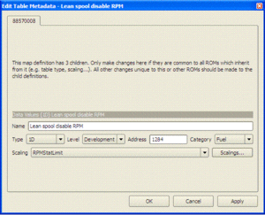

Change the map definition for the 4531 and increase the address by 2 so it reads 7000 RPM. Then alter that.
How do I do that??
I read all bout the lean spool, made it so ECUFlash had another option under fuel, IPW step. That was set to "224", which was suppose to be "7000rpm". I then set it to "80", which according to razorlab is "2500rpm". If I wanted to change it to 1500rpm what would I enter and am I changing the right parameter??
So I did this, then changed it to 1500rpm. After doing this the IPW step changed on it own. So these too things are basically the same thing, right?

If you change the unit to RPMstatlimit it will display as RPM.
But the scaling is 31.25 for each unit, so 1500 is 48 in decimal.
So IPW step and lean spool disable are the same things???
Also, if you change the boost enhancement stop address to 1284 from 1282, it makes that map, the REAL lean spool disable, which is the same as IPW step???

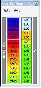

JDM evo 9 RS enrichment if you want a base to work off
From 2000RPM on, the JDM map and USDM map are the same.
