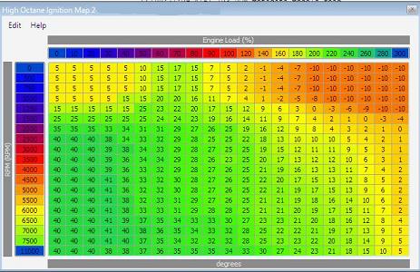

This is my map that a got from a tune last year, I'm not a tuner but I think it can be improve by alot. Some pointers would be apreaciate, specially where to start........ that block of 7s is not safe I think specially on 91 octane.
JDM MR RS map .. though if you look at the timing .. you'd probably not be able to run this map without any form of octane booster ..
Have fun with the reference !

Thanks but that map is too much over the edge, I don't think even with 93 octane it would work.
