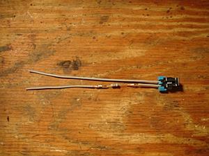

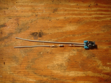

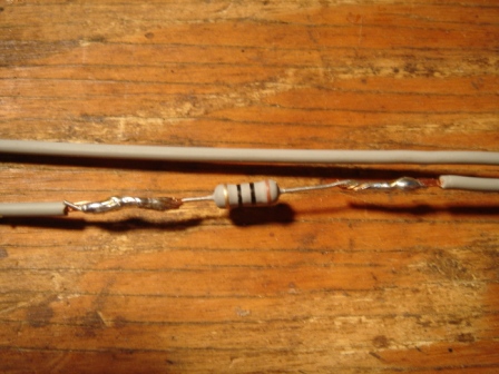

You need to solder the resistor inline on one of the wire on the pigtails.
Step 2
Cover the connection with heat shrink
Step 3

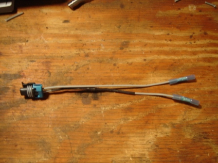

Remover air filer and stock boost control lines and solenoid. Use the last how to for info on this.
https://www.evolutionm.net/forums/sh...d.php?t=227006
Step 4
By now you have the stuff removed. Connect the pigtail to the stock wire. I cut off the solenoid and connected with butt connect that were included with the pigtails. There is also alternatives, you could solder it and you could also use in-line taps, so you dont have to cut the stock plug off.
Attached Thumbnails HOW TO - Control boost using ECUFLash and 3 port GM boost solenoid-dsc00507.jpg   HOW TO - Control boost using ECUFLash and 3 port GM boost solenoid-dsc00508.jpg   HOW TO - Control boost using ECUFLash and 3 port GM boost solenoid-dsc00510.jpg   HOW TO - Control boost using ECUFLash and 3 port GM boost solenoid-dsc00521.jpg

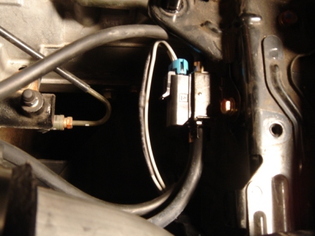

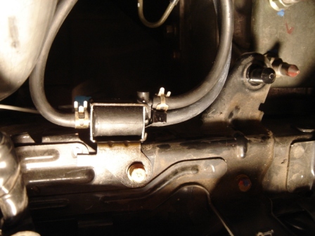

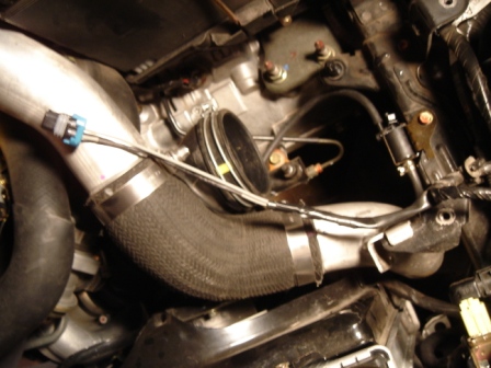

Step 5
Now you have to mount the solenoid. The first way I mounted it DID NOT work with the stock intake, but will work with an aftermarket intake.
This way will work with the stock airbox.
Step 6
Now you have to run the vacuum lines. You WONT NEED ANY brass restrictors/boost pills or tee's. Here is a pic of the GM BCS. Pretty self explanatory. Port "A" goes to the wastegate. Port "B" goes to the lil port on the bottom of the stock intake (If using a aftermarket intake, the line can just VTA, if there is no lil port on the aftermarket intake). Port "C" goes to the the nipple on the turbo/turbo outlet pipe (or other source of vac/boost)
Attached Thumbnails HOW TO - Control boost using ECUFLash and 3 port GM boost solenoid-dsc00523.jpg   HOW TO - Control boost using ECUFLash and 3 port GM boost solenoid-dsc00525.jpg
