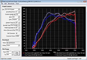

I have Quicktime Performance's electronic downpipe on my car, so I did a test with it opened and closed. I have an 03' with K&N air filter, downpipe, flash and boost set to 21psi in the open cutout mode. Closed, boost drops to 19psi and runs richer by about .3 AFR wideband (10.9 vs 11.2 on avg). Here are the power results (I took the average run on both open and closed to keep data from being skewed from those hero runs). This confirms the idea that no back pressure is better, because in open cutout mode, the car spools up about 150rpm's faster.

very impressive gains!

It all depends on what midpipe and catback is being used. I suspect that there could be as little as no gains if using a cutout with free flowing 3" exhaust.

I have stock catback still. My main reason on getting the cutout was to have the best of both worlds, quiet and loud when I want it.

an interesting test would be to pit it agains something like the best BR exhaust on a dyno. I'm sure the higher the HP engine the more substantial the gains would be in favor of the cut out.

yea but then again you can save lots of money by just getting a cutout

very good gains and thank for the test. i'm thinking of getting the cutout too.

ur seeing such a variation because of the stock cat thats in place....
Put a testpipe in and the hp difference won't vary as much and the boost will stay the same....
The stock catback on a stock turbo car is good for 10whp max. I trap less than 1 mph more with my cutout open versus closed. i run a megan downpipe and ultimate racing testpipe.
If you notice the main difference is the 500rpm faster spool with the cotout open. Thats the main reason i run it.

Did you mean 10 whp peak or are you also implying a maximum of 10 whp anywhere under the curve?
