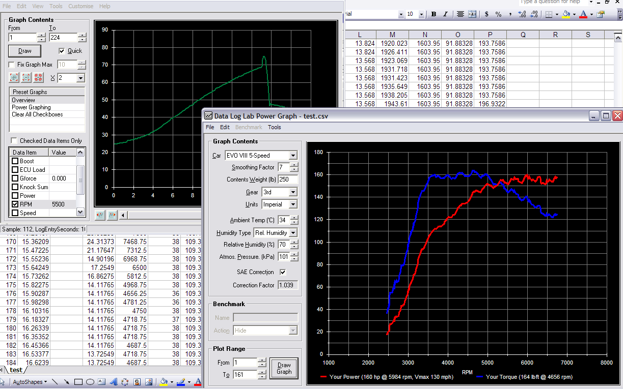

Here is a log I did a few nights ago...
One thing I noticed about the timing: Any change in timing, ie. if I add 1 degree anywhere, it starts to show 1-3 counts of knock, adding two degrees brings me past 6 counts and starts to pull lots of timing. One thing I noticed in my back to back logs, 1 count of knock is pulling timing! What the shizzle? I though 6 is what starts to pull timing. I have hard evidence that one count of knock is pulling one degree of timing in previous logs.. Is this right?
Would someone mind throwing this into DLL and showing a power graph for me, as I don't think mine is showing me the right numbers.. I used approx. 250lbs in the car (Me + a few things), the air temp is on the log I think, if not, it was around low 80's I believe, and the humidity was freeking rediculous. I am also running 245/45 R17's, which is an overall diameter of 25.3". I just want to compare what I am getting to what someone else get's because I think it is saying I have a lot more power than I really believe.

Is your datalog in 3rd gear or 4th? I put it DLL... it does not make sense in 3rd
When you let off RPM spiked so I cut the RPM data right at the last entry with TPS at 100%. The power graph was done using 3rd, your tire size, default evo weight and temp from the datalog converted to *C. In 4th power is 301
OK, pardon my ignorance, but where do you get DLL?
I am using the graphing in EvoScan.. Is DLL a separate program?
Hmm, the log was done in 4th gear...
I need to find out if my dyno on the Mustang was in 3rd or 4th.
Something doesn't make sense because I dyno's at 303 and that was 5 psi less than what the car is at now, and with the addition of an Injen I/C.. Something isn't really adding up...
Data log labs at http://www.flyinmiata.com/index.php?...7000%20%20FULL "for other ECUs"
