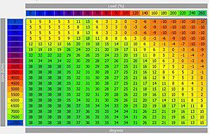

So, does your fq340 ignition map look like this?

^^^ IRT the above ign map..... Don't the FQ maps go to 300 load?
I guess the IX FQ do, not the VIII FQ
