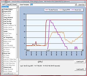

I experience the same thing..I need towork this out as soon as I can get ecuflash working again..Here is a perfect example..

Pete, the knock was almost back to zero by the time you let out the clutch though.
Thats how it should look, the initial high knock spike doesnt matter (its gonna happen) but it is supposed to be ignored and almost immediately decay as soon as the VSS sees movement. This is what happens in 95% of the cars I have tuned and logged. If Cookie is having that knock not leave until the middle of 2nd gear I wonder if some signal is not getting through to where it should or something else is going on.
