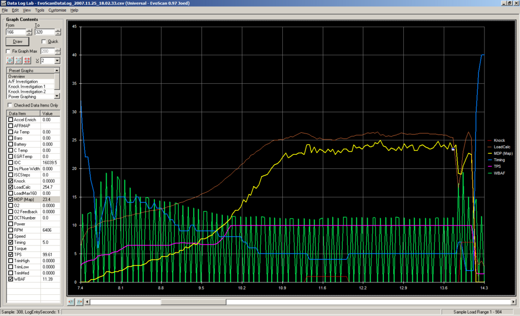

Update!
Well....
I did a couple of things this weekend!
1. Replace pads and brake fluid on the Evo. Pretty straight forward with the right tools, lubricants, fluids, etc. I installed some Ferodo DS2500.
2. Changed all the vaccum lines for BOV, Intake Manifold and MBC.
3. Modified the preload for the 18PSI WGA. It was on the standard setting and did an additional full turn for the high setting.
4. Performed a Boost Leak test. Everything to be OK. No noticeable leaks!
After bedding the pads... I went to re-tune the MBC for the change in the preload. With MBC all the way up.... I am getting 20-21 PSI! Good!
Tuned it for a good ~25 PSI peak as before.
However, after a test pull on a highway I noticed that the car was pulling nicely and all of the sudden it stalled like when you accidentally press the clutch with the NLTS. Came back home to re-check and everything seems to be fine.
I decided to go out one more time with the logger on and this is what I got. Please refer to the red oval in red.
As you notice, I did not lift the throtle and suddenly the big drop in boost. It felt like a very bad backfire or a Intercooler Pipe blew off. Any ideas? Well... at least I do not have the dip in the 5000-5500 RPMs anymore.

Bov opening? What BOV?

Evo IX OEM Metal BOV. I have a forge BOV lying around somewhere! I will try to swap it and see if it does it again!

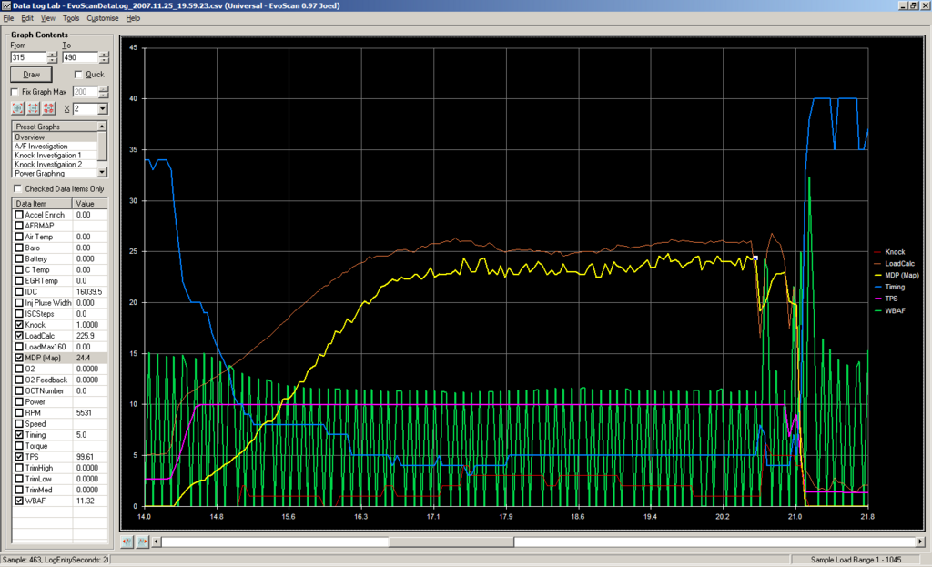

Exclamation Update - Sputtering Again! :-( WTF
Well.... I checked everything one more time and could not find anything wrong with the car. But.... A similar behaviour happened again. The boost drop re-appeared. But this time with two codes... P0000 and P0234. WTF!
Now, definately I have no clue what may be causing this! I will start narrowing things down from the basics I guess.
Here is the screesnshot! (Note: the point selected in the graph was showing 24.4 PSI and the next point was 19.2. Big drop haaaaa!)

Could you take a pic of your engine bay and post it. Close ups of the BOV and piping would be preferred.
