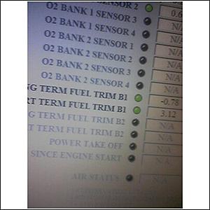

Excellent, Im using evoscan 2.0, so it lists them in that order but based of the 100 value, I have an OBD II scan program that is giving me the ltft correction which is the -.78 %, for some reason the LTFT High on evoscan 2.0 does not move? I posted some pics.
Attached Thumbnails Normal Range For Fuel Trims +/--2.jpg   Normal Range For Fuel Trims +/--3.jpg

The last one on left was 02 feedback STFT. the 100.78%.

Anyone wanna check the pics?
